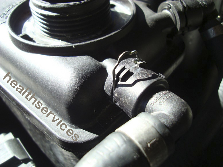

Reservoir has two screws, only complication is they are Torx, then lift up, there is a electrical plug underneath, unplug that. the hoses are easy to remove just a single clip for each one. just lift up to the position shown below, no need to remove clips completely, then pull hose off. Don't lose the clips!!!!

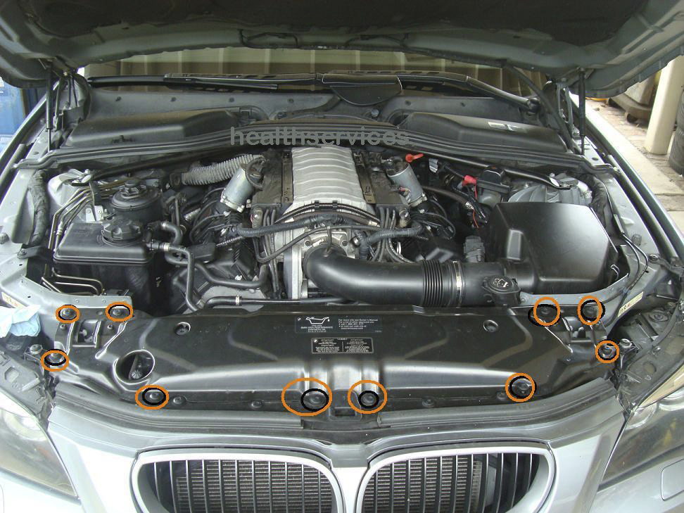

Remove the upper radiator cover, again more Torx screws.

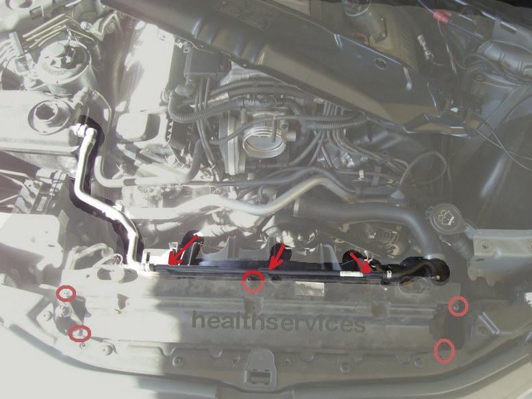

The arrows below point to the hose, no need to remove these screws.Use some dikes to cut band off of the hose at the radiator end, and if there is not a replacement band use a hose clamp.
