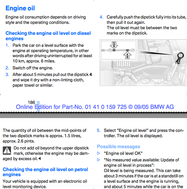

Are you checking the oil level using the proper procedure? I.E. Drive it first...

hi there lads thanks for the info i dipped the car and its bang on the max so i should be ok i hope no warning lights or nothing showing on the dash thank god
