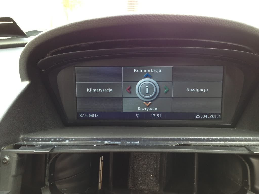

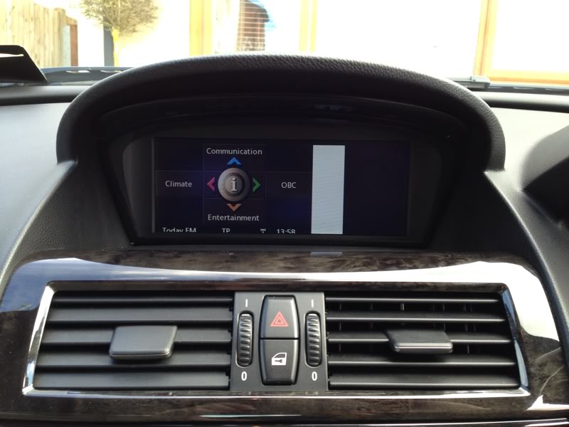

this is how the i-drive menu screen looks(picture#1) after just swap it with the 8.8"
so..who can see if the resolution can be change to look like the second picture?
best regards
STELI
