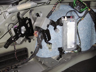

Originally Posted by Ellicit' post='801952' date='Feb 26 2009, 01:56 AM
I'll double check tomorrow... but I didnt see any amp, isnt it locaed on the leftside?
Yes, its a little silver box mounted on the back of the wheel well on the drivers side. Its about the size of a box of raisans or arm and hammer for your fridge. See attached picture, its right in the center.

yes I do have that =D
What wire is what, any detail on that
thx
