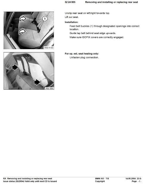

I have annoying squek/rattle coming from the back seat. i could take it to the dealer but i really don't want to. i want to try to fix it myself. to do that i would need the instructions on how to remove the back seat so i can look at it.
anyone has the instructions on how to remove the back seat on e60?

Removal of bottom rear seat
Attached Thumbnails How to remove the back seat?-removing_and_installing_or_replacing_rear_seat.jpg

thanks
