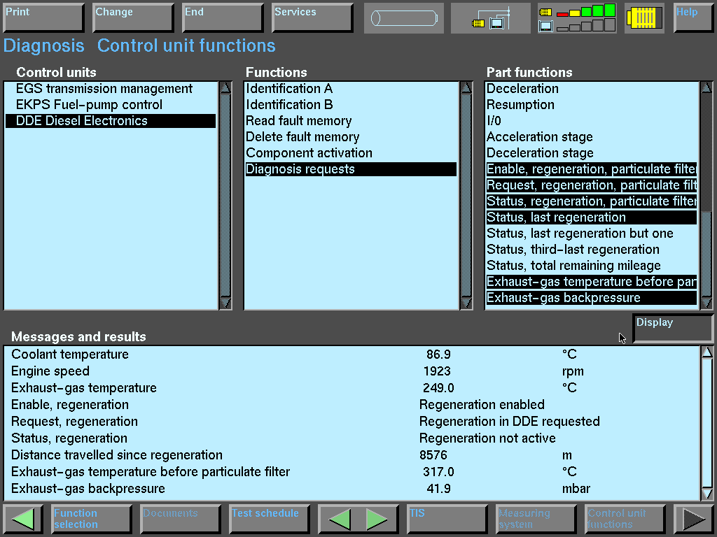

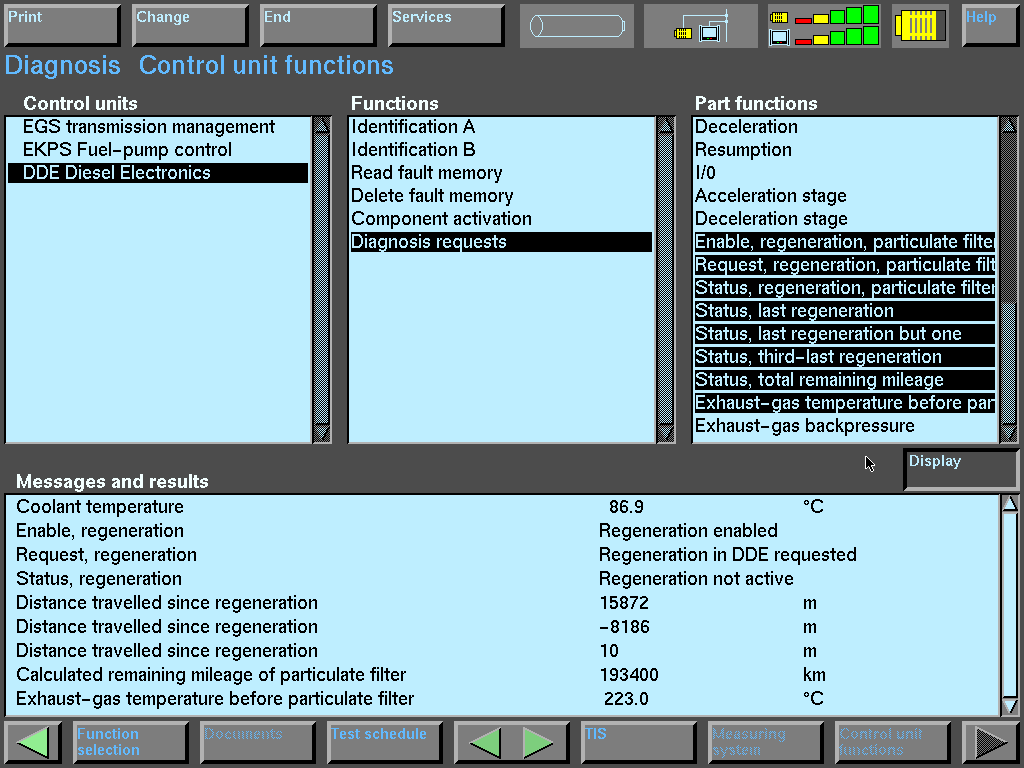

Hello everybody,
I post here because, it's the best place for talking about particle filter in the web
i have a 325d from 03/2007 with 68 000km and this model of particle filter :
i have no message errors in DDE, no fault in my car, so diag is good.
-> but with DIS i have seen that the status in DDE, is always in "REGENERATION IN DDE REQUESTED"
So i decided to make a test with DIS, and the exhaust back pressure is good :
Normal, because no warning message.
I always do highway at 110 - 150 km/h, 70km.
So engine hot, exhaust temperature above 240degrés etc ... but i have the impression that the regeneration did not take place.
So my question is :
How do you do for force the regeneration in DIS ? it's in the menu after the SAV fonction where you can test the exhaust back pressure ?
T think, that if i force a regeneration, my DDE status become normal.
Thanks
