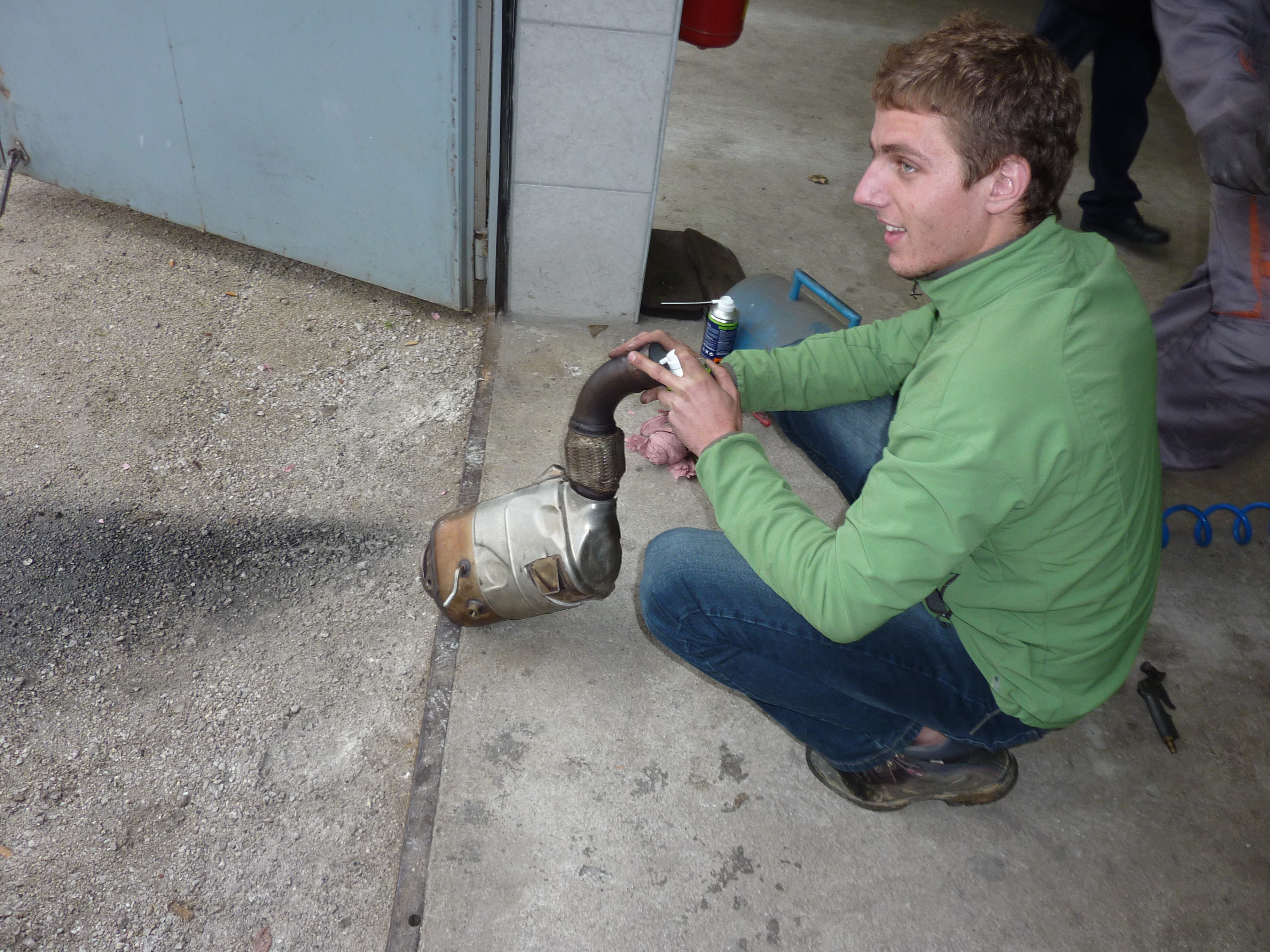

Here are the pictures of cleaning:

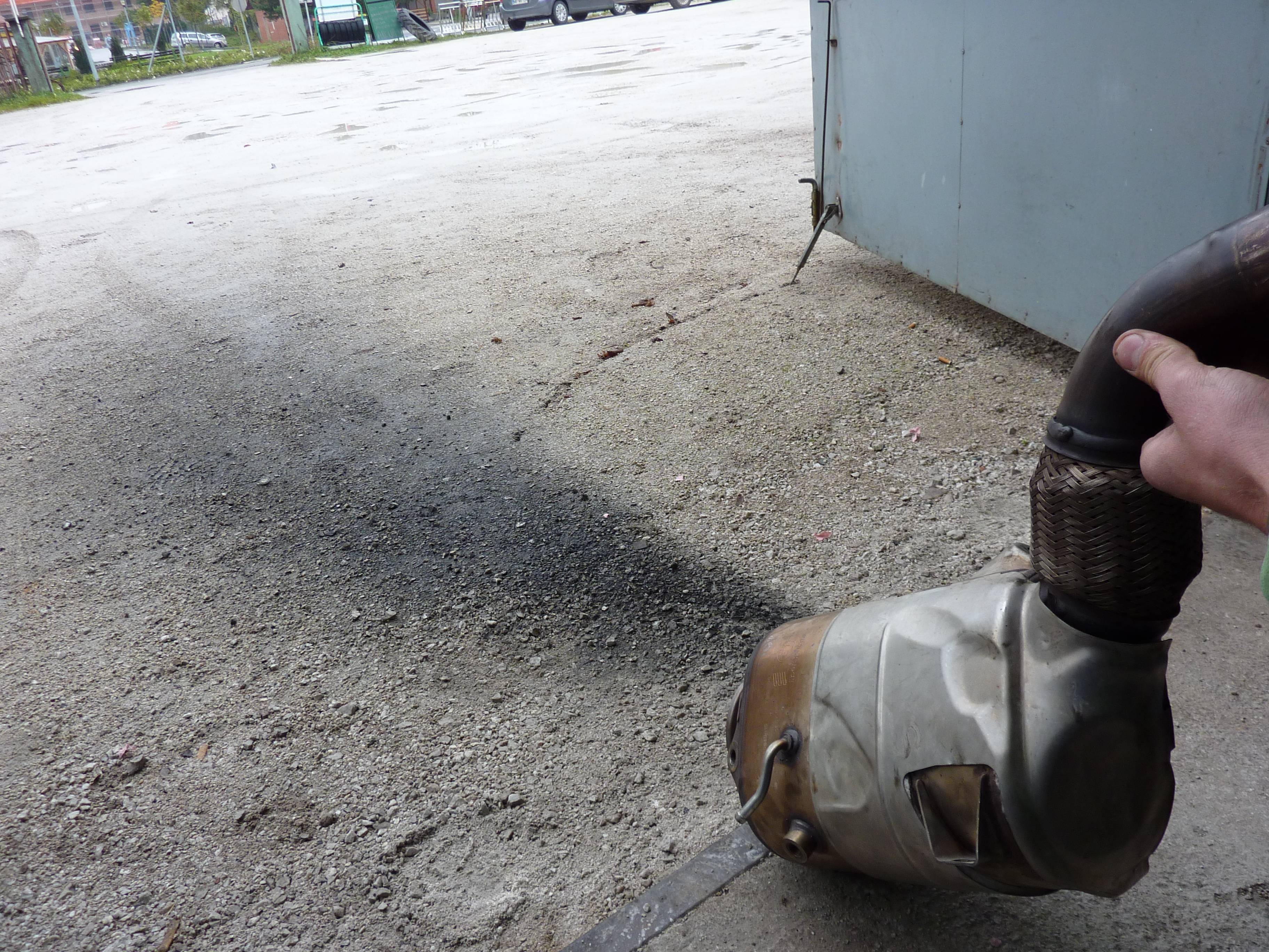

See the black ashes on the ground:
Here you can see the "air buster" the blue thing behind the DPF.
We use the brake cleaner and gas, I thing 10 liters.
Now car work like clock. Before cleaning the max. speed was 230 now I had 260 it was not over I run out of road
The consumption is better.
We start at 14:00 and we were on test drive at 18:30. Doing that without mechanical car lift is almost not possible.
Bye,
Andrej
