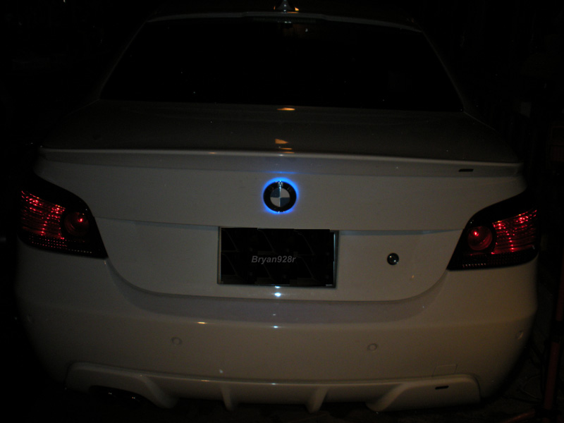

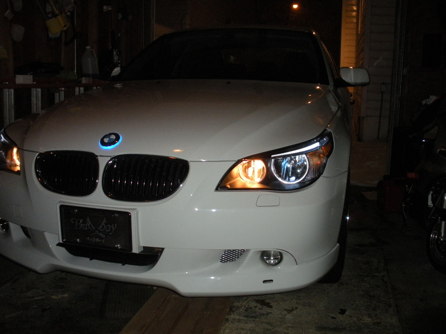

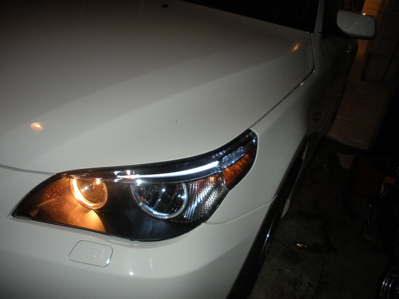

I've dome mine a last year. the pictures aren't that great but they are very bright. I also made the halo rings under the BMW emblem window blind acrylic rods which I heated in the over and wrap around a can

Oh wow that's cool. How did u power them? Where's the led? Can u see the ring during the day?

I attached the front lights by passing the wires through the hood down to the hinges and back to the eye lids. The back lights to the license plate lights. The rings below the emblem is about an eight smaller then the emblem so the rings don?t show. I drilled two holes under each emblem and install two LED bulbs. The two bulbs are way brighter than one LED. The hard part was drilling the holes, it hurt more mentally. The rings are very bright in the night but not that bright in the day.
