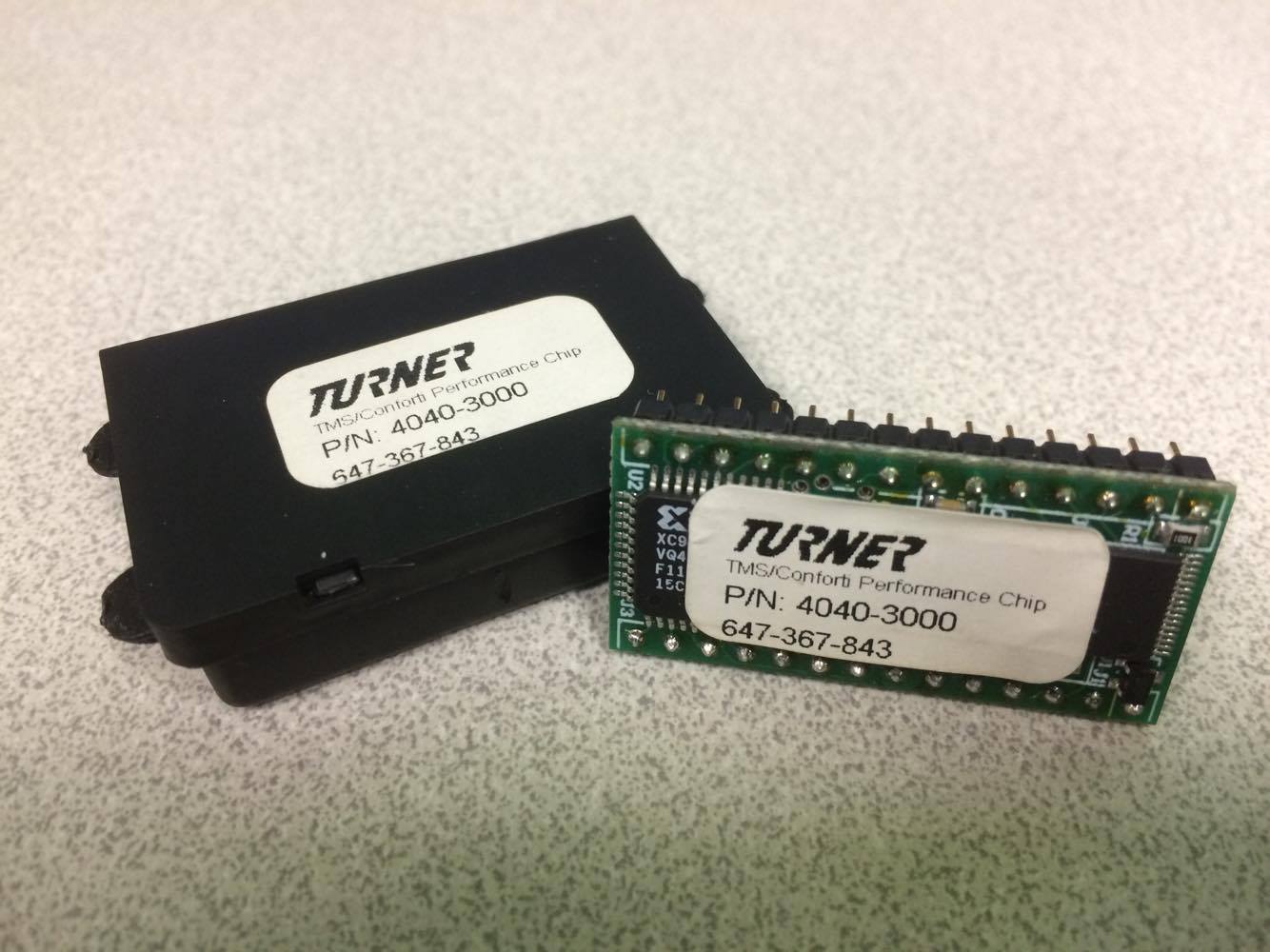

Installation is considerably more involved than today’s plug-and-play handheld tuners, but it’s still a relatively simple, straightforward process. First the Motronic DME is removed and disassembled to gain access to the circuit boards. Then, a small chip is removed and replaced with the Turner chip. Finally the unit is reassembled and reinstalled into the car.
Thankfully, Turner Motorsport includes detailed installation instructions with each chip. An average hobbyist should be able to tackle this project in an hour or less.

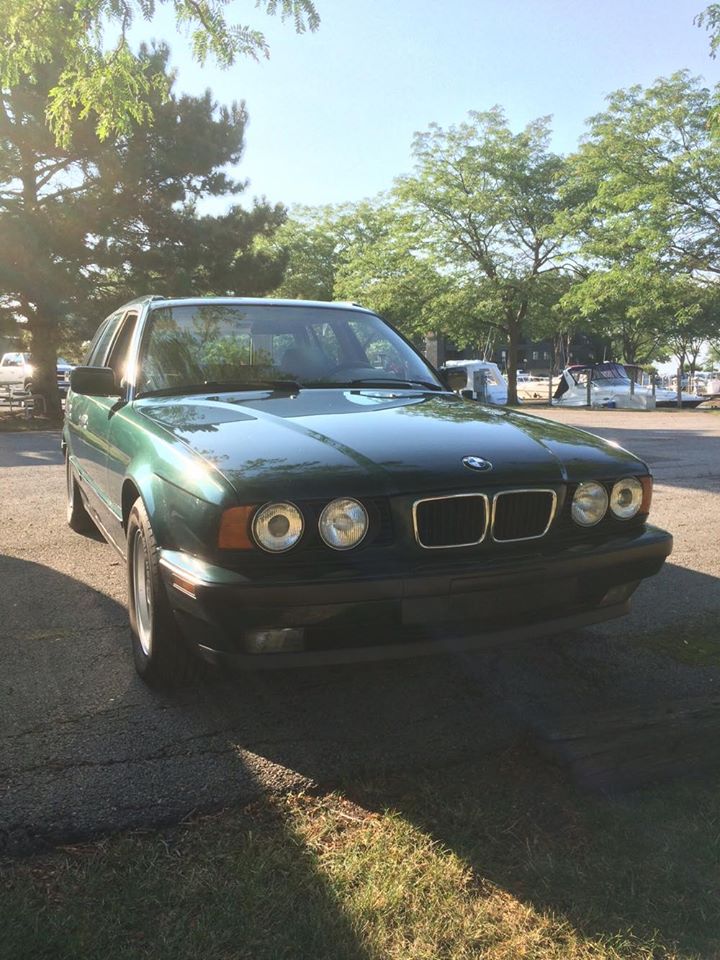

1994-bmw-530i-touring-4
What struck me immediately was the vastly improved throttle response. I had never noticed how much lag there was in the system before. My car finally felt like a thoroughbred sport sedan (or wagon, in my case). The response, in my opinion, is tuned perfectly. It’s not a touchy, hair-trigger setup, but the car feels ready for action at all times.
While there is a definite increase in power (Turner Motorsport claims gains of 23 horsepower and 23 lb-ft of torque), the improved throttle response is by far my favorite improvement. While waiting at a stoplight for my next chance to exercise this newfound power, I noticed something entirely unexpected: a smoother idle.
BMW’s M60 V8 has a somewhat loopy idle that’s surprising and even a bit disappointing to a BMW fan accustomed to the smooth operation of their legendary inline sixes. I’m happy to report that the Turner Motorsport chip smoothed the idle considerably, making it on par with BMW’s newer, more refined V8s.
What was most shocking, though, was the difference in fuel economy. Previously, I had done my best to hypermile the car, delivering a respectable 19.6 miles per gallon in combined city and highway driving. After installing my chip and spending an entire weekend exercising my BMW’s new capabilities, I was shocked to see the car deliver close to 21 mpg. I’m interested to see how that number improves as I begin to drive more conservatively again.
