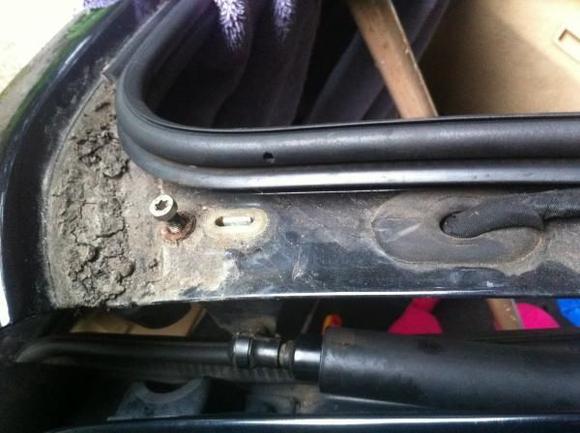

This shows where silt gathers just under the lower corner of the tailgate glass. This appears to be (another) design flaw. On the other side of mine, the paint is bubbling and needs to be repaired. I think it could do with silicone sealant around the trim to prevent water ingress.
