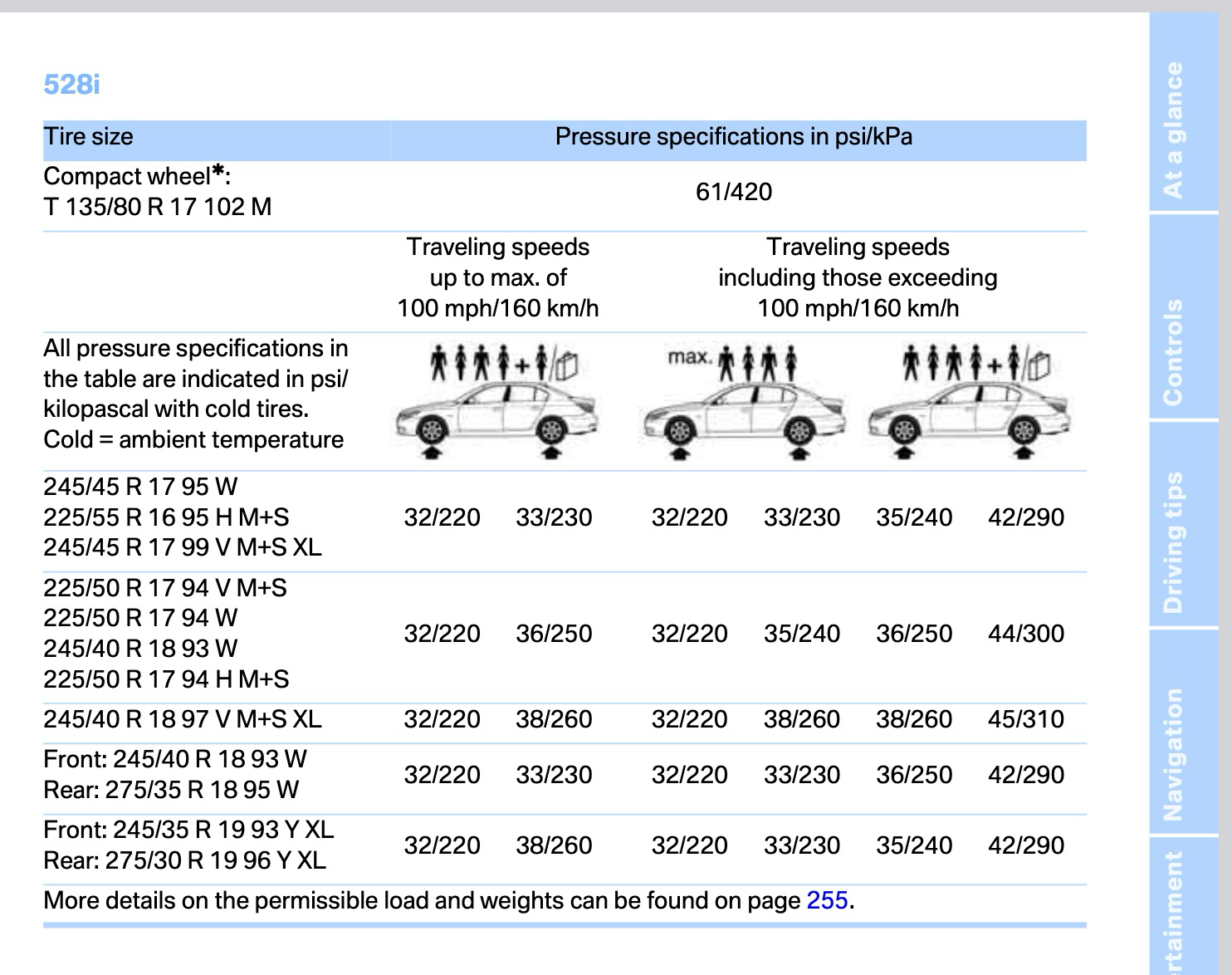

owner's manual:
https://5series.net/info/2008_5_Series_Manual_US.pdf
stick with what's allowed in this table:
