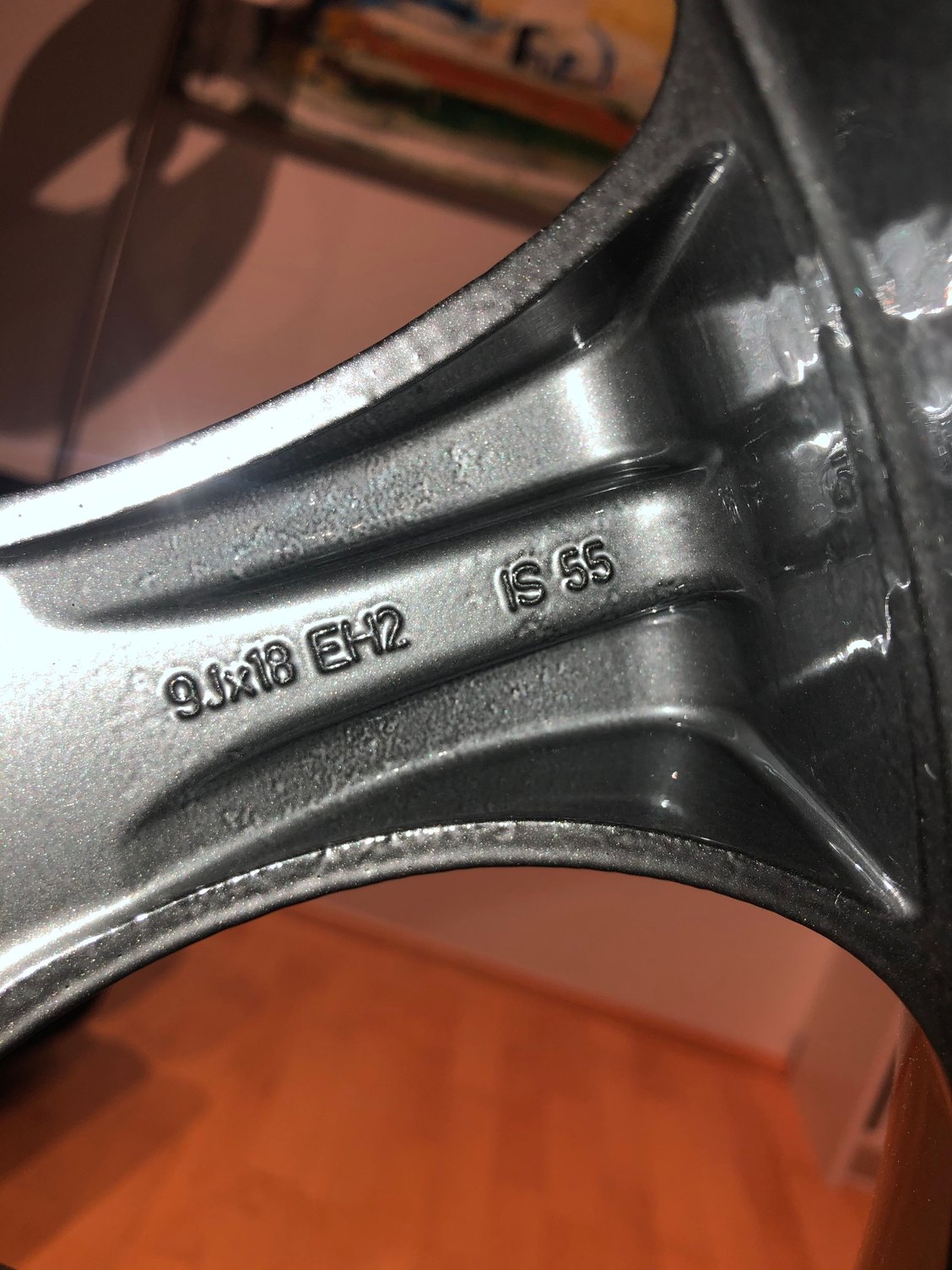

Damn I'm not sure, they came with the car new in 2006
Does this help?

There's your answer right there... 43 front, 55 rear. Play around with different 18" tire size combinations in www.willtheyfit.com. As long as the rolling circumference doesn't vary +/- 3%, you're golden.
