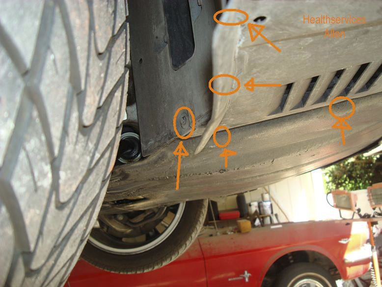

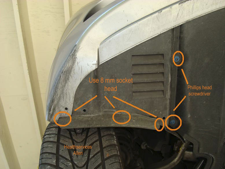

The wheel liner does not need to be removed. There is like 3 bolts that hold the lower cover at the bottom of the wheel liner. 3 min job if you have the wheel turn all the way in and willing to lie down..

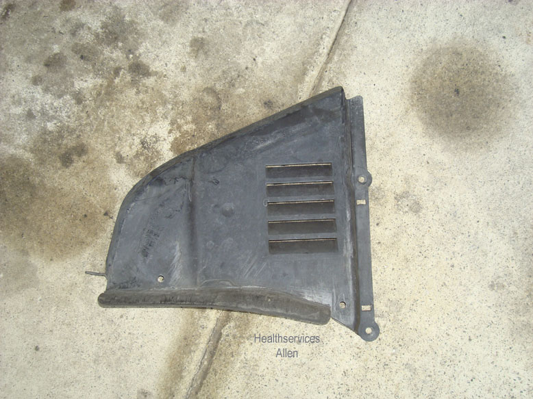

In case you have not figured it out...
The cover totally is removable.
The three bolts are on the tire side.
