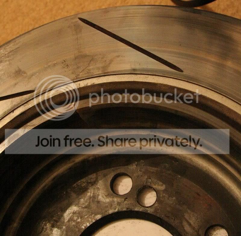

Interested in your thoughts on this. Removing the rear brake disc (AP which had been fitted 7 weeks earlier, not std CSL) whilst investigating a ticking noise discovered this crack:

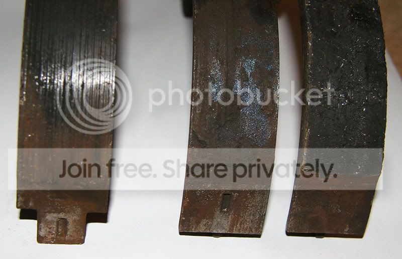

And removing the handbrake shoes discovered this:
The one on the left was removed from the other rear wheel to show a comparison of what it should look like!
Clearly one of the shoes had been ground down to nothing (how?), and the heat as a result has caused the other shoe to crack badly. The heat of metal on metal has caused the disc to crack
The Hub had to be replaced as well, due to heat stress (it was blue!!)
Any thoughts, or has anyone seen this before?
