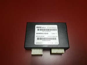

I'll check but this is what the module looks like. EDC=Electronic damper control
Are you sure you are not looking for the EHC? That is the rear air suspension module, and is the white module in the bottom-left of the photo above.
You know I think you may be right. I am going off of the information that Protools sent me. I'm not sure if they can make the distinction between E60 & E61. I believe you are correct. I will try the EHC module first since my vehicle doesnt have EDC (At least to my basic knowledge. It wasn't a sport package vehicle). Thanks for the insight.
