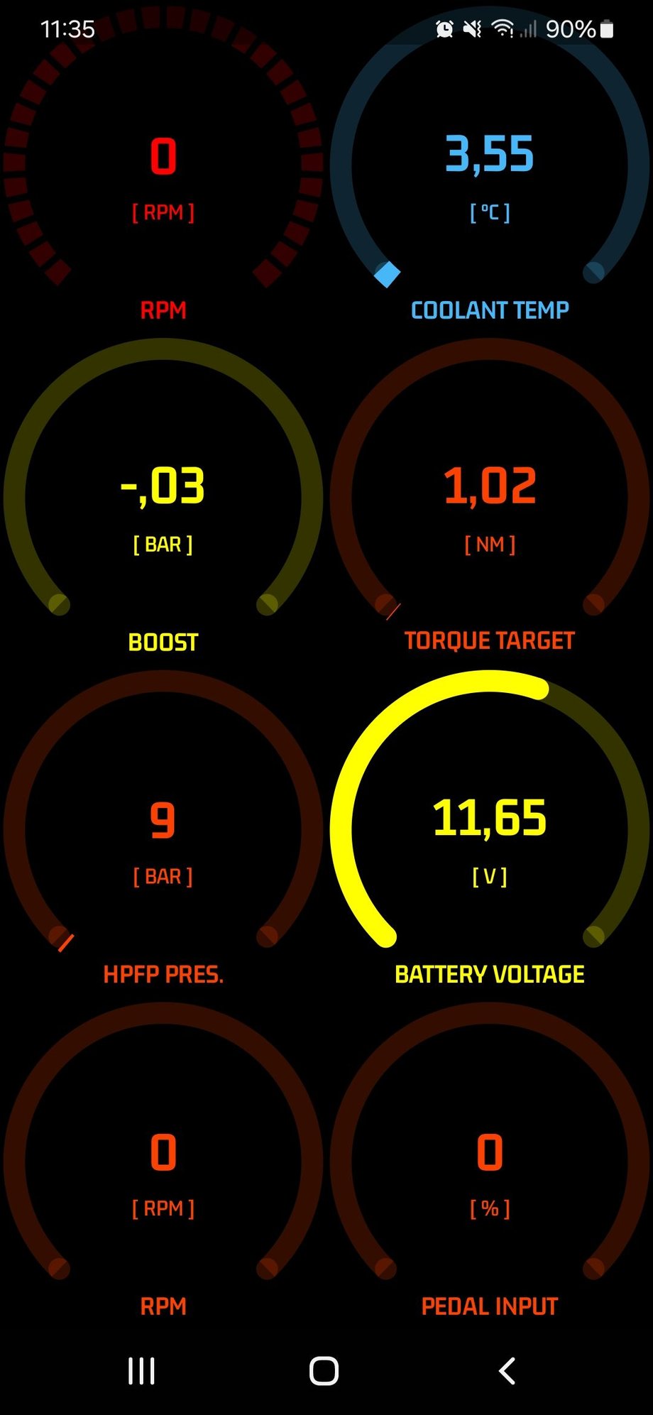

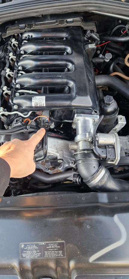

So went out today +2 c weather. I forgot the mhd obd reeader in it, so car gave me a warning of drawn power and showed 11.65v. Before starting i took of the engine cover and unplug fuel pressure, throttle and the sensor beside nr1 injector and blew on them and put them back.
I checked my battery was registred and it was at 105ah standard. So i did a new one with 105agm
SILVER dynamic
www.varta-automotive.com www.varta-automotive.com
Then pushed start button and started instantly and started charging
15.13v, dropped soon to 14.76v
Drove it 20km cold and did some wot on higher speeds and standstill.. Didnt matter, car just went like a bat out of hell.
When it came up to 70deg celsius i turned around, gave it all. From standstill and highspeed. Manual, sport, automatic. Shut it off, started did the same
Worked flawless with 1.5bar at woot,529nm torque, 1604 bar hpfp pressure.
So for now i couldnt recreate it. And i only have protool and my hands since im not at home.
Car off
First start efter registred 105agm
Dropped down to this after few sec.
First time seeing this, would stop charging at all, maybe because coded a new battery?
Full wot, 1.5bar,529nm,hpfp 1604bar
Battery.
Blew in them.
Blew in them
Blew in them.
