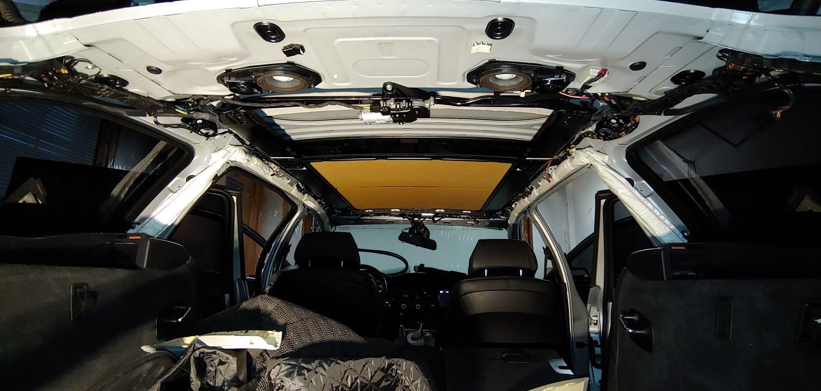

-E61 M5 Black Headliner, Pillars, Euro Visors

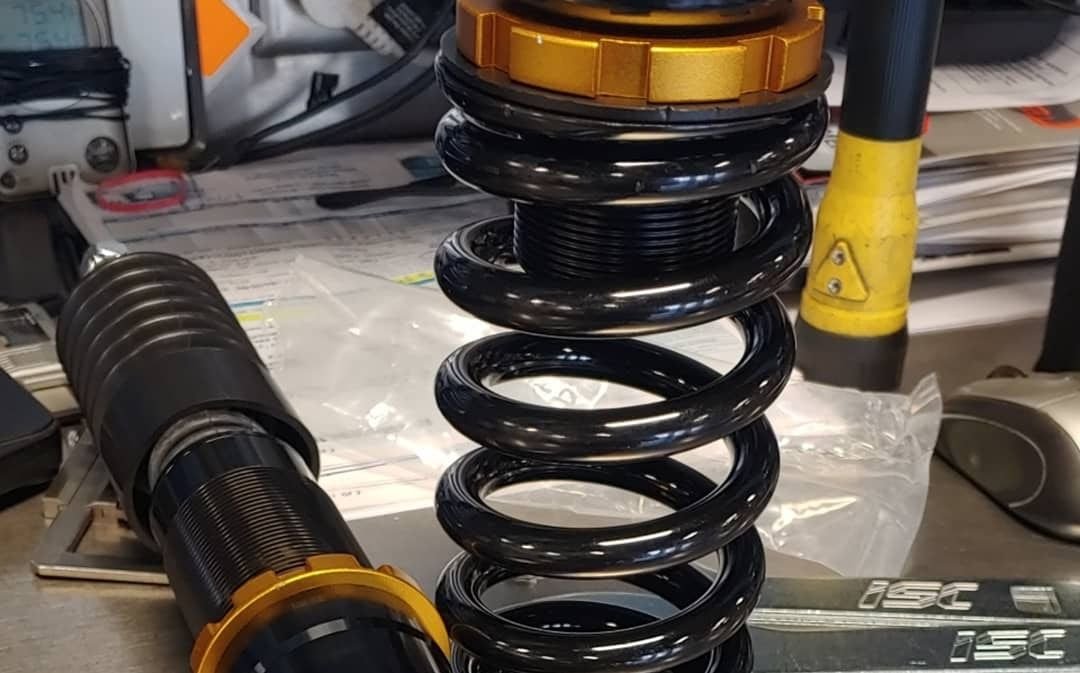

-ISC Street Comfort Coilovers

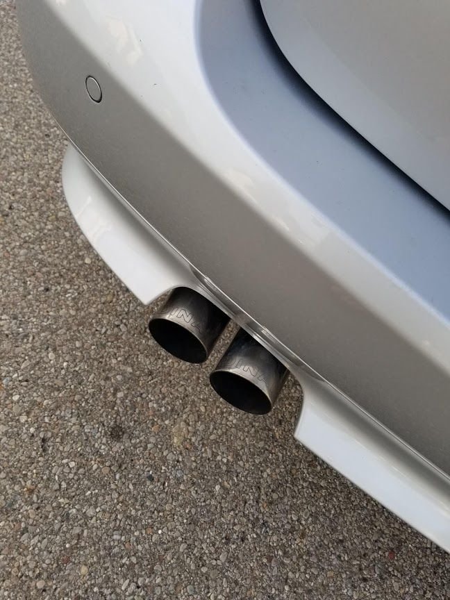

-Dinan Axleback Exhaust

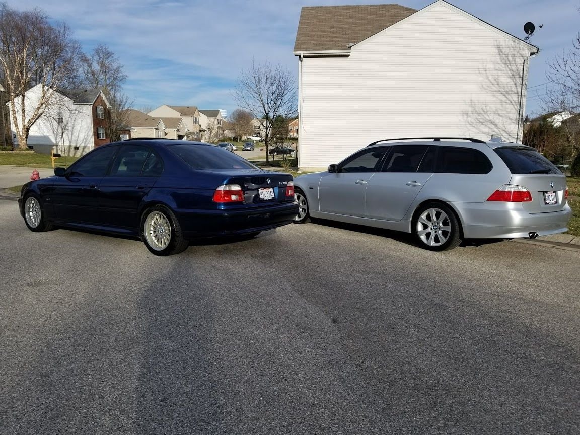

1/23/18-Delivery Day. A friend and I took the 4 hour-ish ride from Cincy to Akron in my 540i6 and of course had a blast on the way back

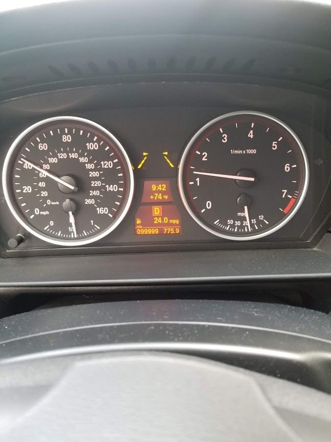

Nearing the big 100k

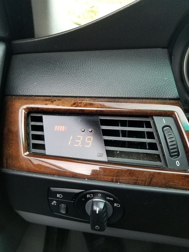

Post P3 Install

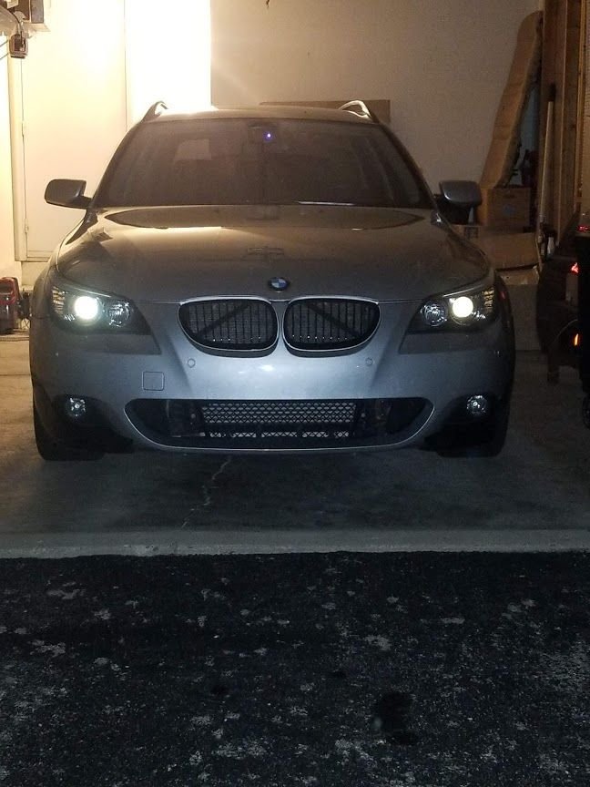

Yay for Dinan

In Process Replacing Headliner w/M5 bits
UK Spec M5 Headliner-Complete
ISC Coilover Install-8/2019

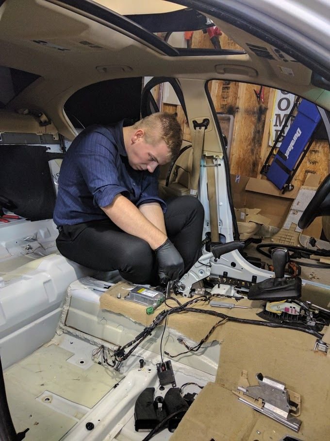

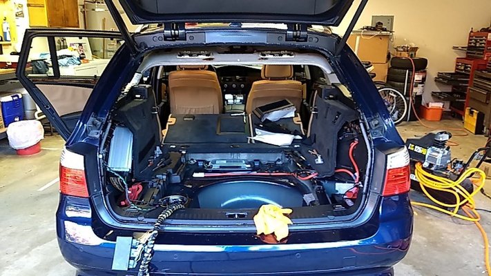

My buddy and I now have 2 NBT retrofits under our belts, one is in my E39 and the other in his wife's '04 E60 530i. Last year we did a...interior revamp on the latter. Her car was originally venetian beige, no nav, etc. We did E66 760li Front Seats, black carpet, NBT, Silverstone M5 door panels & console. We dyed her original dash to silverstone(actually turned out fantastic), leather wrapped pillars, m5 headliner, all kinds of stuff. It started when a sunroof drain leak went unnoticed for an extended period and much of the interior was beyond saving....so since we're maniacs we went all out. Both were done with Raspberry Pi can controllers.
Removing the sea of beige
Leather pillars with contrast stitching
CBS all set
Pre LCI E60 M5 seat button panel re-purposed to control the E66 seat functions.
