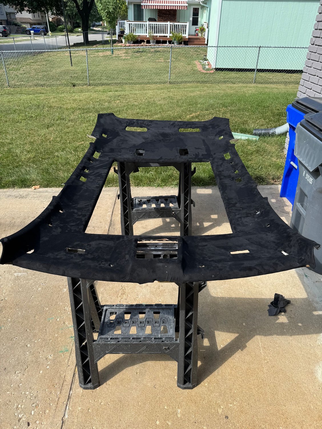

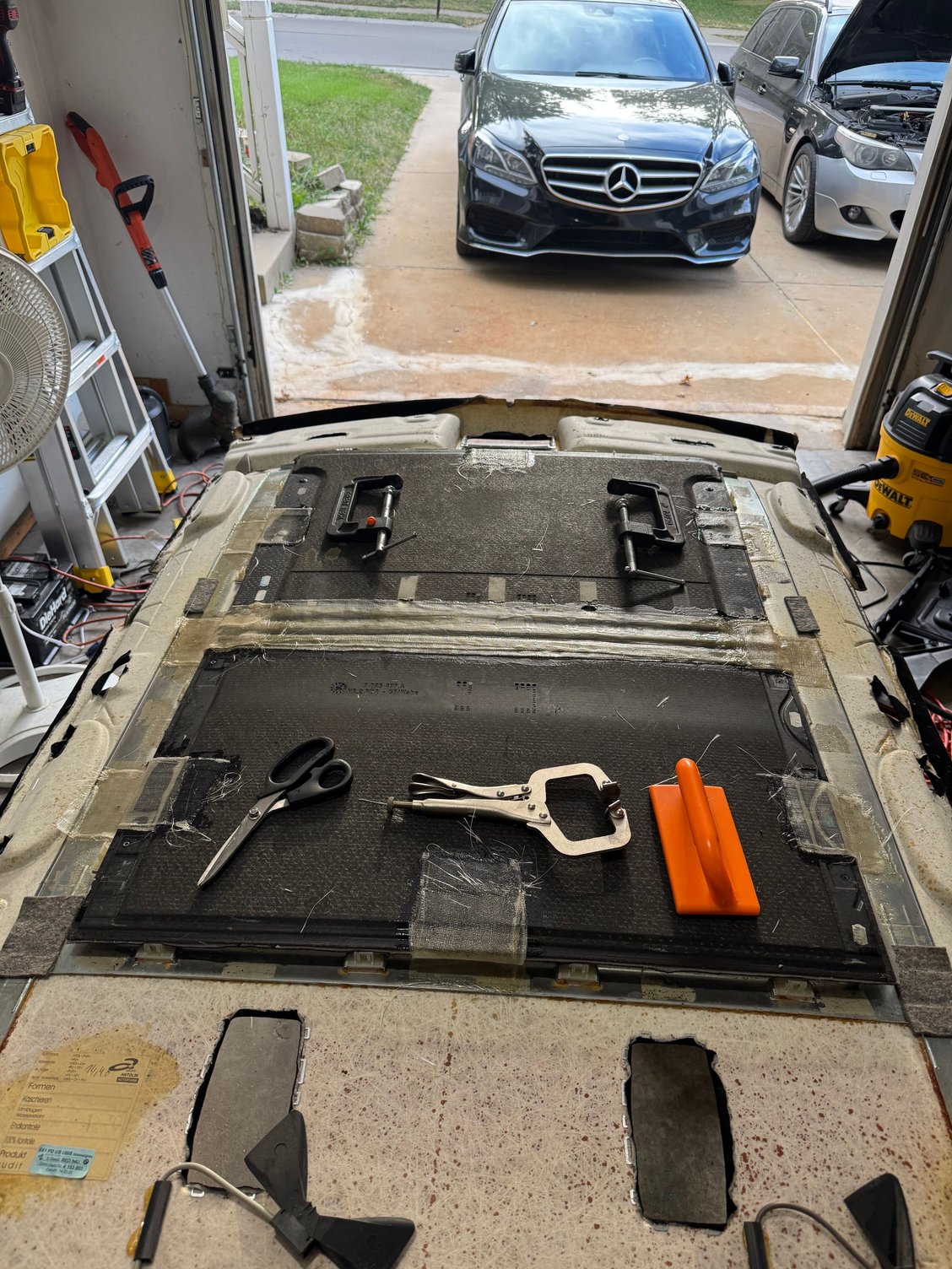

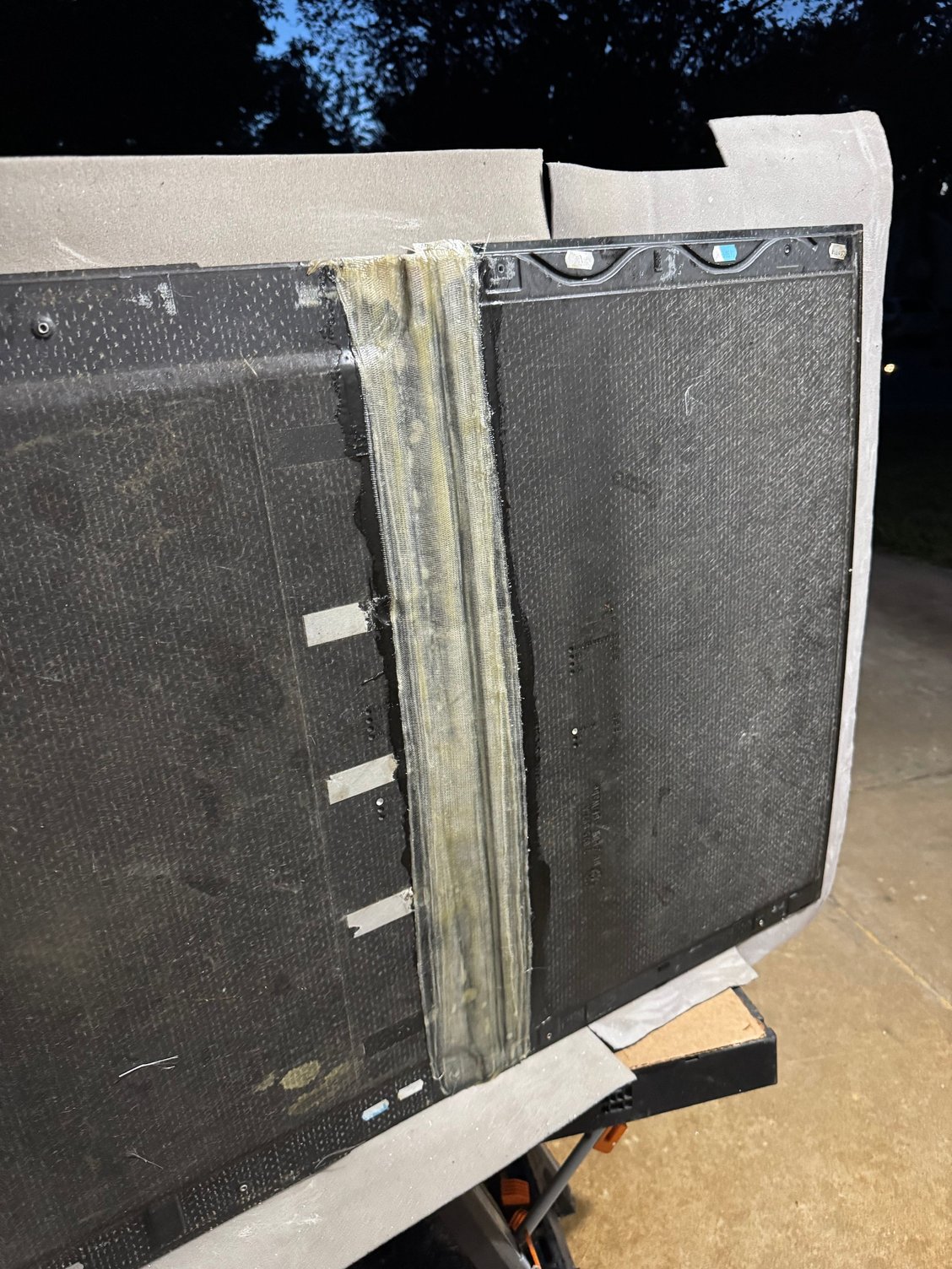

Headliner has been re-installed, but now it's a cheap black suede. I've also re-purposed the pano panels by also covering them in new headliner but then fiberglassing them to the headliner back. As much as I would've loved an actual non-pano headliner, I couldn't justify the $1400+ cost. I will say if anyone plans on doing similar in the future, run the fiberglass around the entirety of the panels instead of strips like I did. It's still plenty strong, but I feel like I could absolutely rip it off with some oomph.
