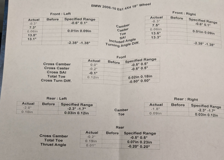

Time for new front struts along with new upper strut mounts and bump stops. Alignment afterwards.
Had to buy a driveshaft puller to pull the axles out of the hubs, best $150 I ever spent on tools.
