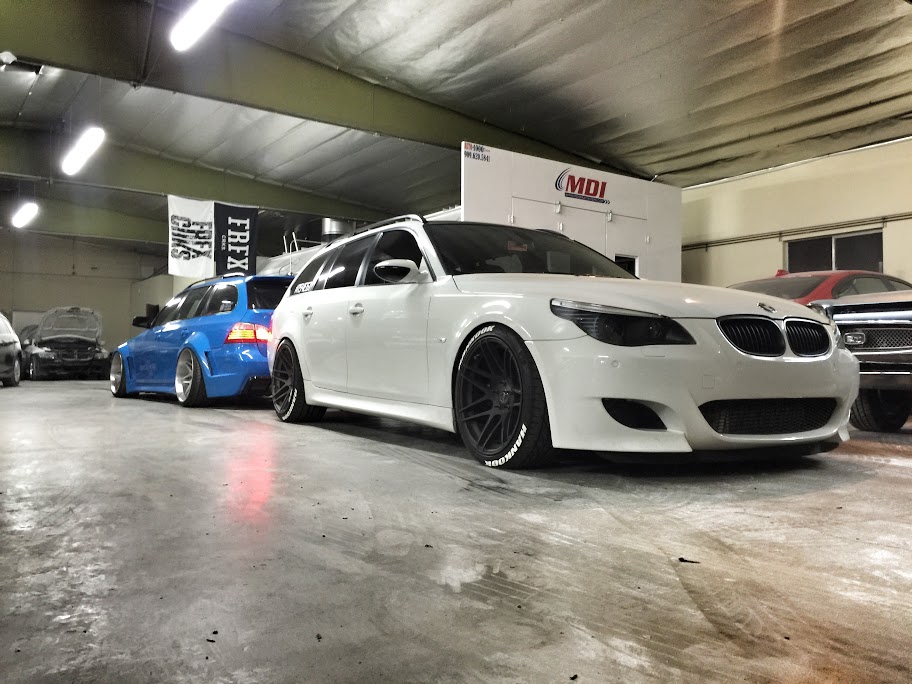

4 Wagons at the shop! 2 E91s and 2 E61s (Mine was parked outside)

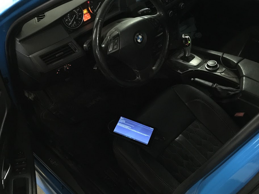

The gauge cluster is a Christmas tree with error messages and the list of codes I pulled with INPA was very long. The car runs rough and has misfires so it is time to start with the basics.
New plugs, throttle body service, and a valve cleaning.
