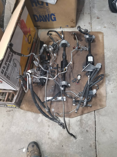

Thanks! That's a helluva lot of work. More than I expected. This is a lot to pull:
(pic from the thread linked above)
And there's still no mention of how the static swaybars feel in comparison or the necessary coding.
His build thread seems to be all over the place with no rhyme or reason as to what he's doing. He casually mentions adding a single turbo and making a drift car out of it. I'm not on FB to see how it turned out. But, his YT doesn't show much of any progress. Just more mess. Evan's builds were much more on-point (and inspiring as well).
I'm not giving up on the idea yet. I have OEM M5 front and rear swaybars in hand. Still trying to figure out if it's much of an upgrade...if at all. Looking at the videos above, it works.
