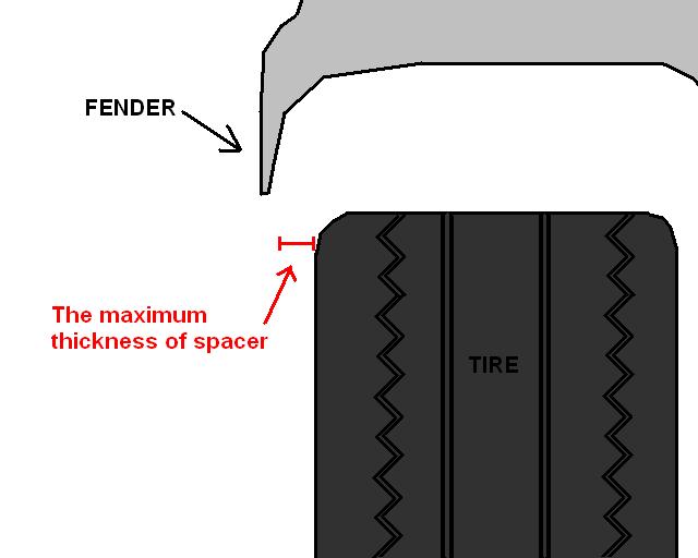

Check the backside of the wheels. If it's not there, then try to find the information from the seller's website.
To determine the size of spacers can also be done by estimating/measuring the free space between the tire and the edge of wheel well:
Old Jan 31, 2010 | 06:01 AM
barton2002's Avatar
Joined: Oct 2009
Posts: 122
From: united kingdom
thats a really nice diagram! thx very much!
