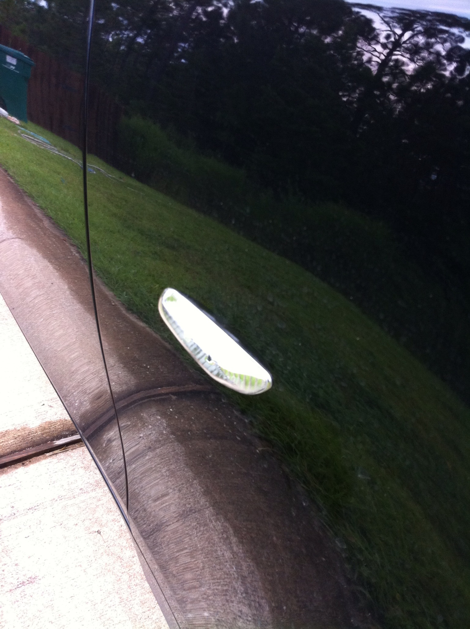

I just put these on. eBay item 190707908015.
Attached Thumbnails Side Turn Signal Lites-46dc14cddd04b2f00504c1ac88783f4a.jpg

looks good.

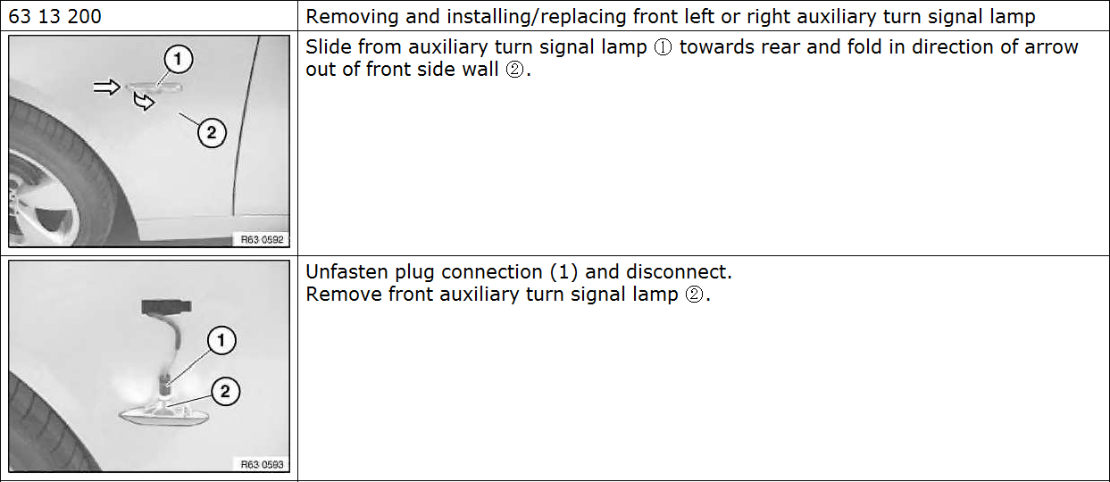

Simple as that.
