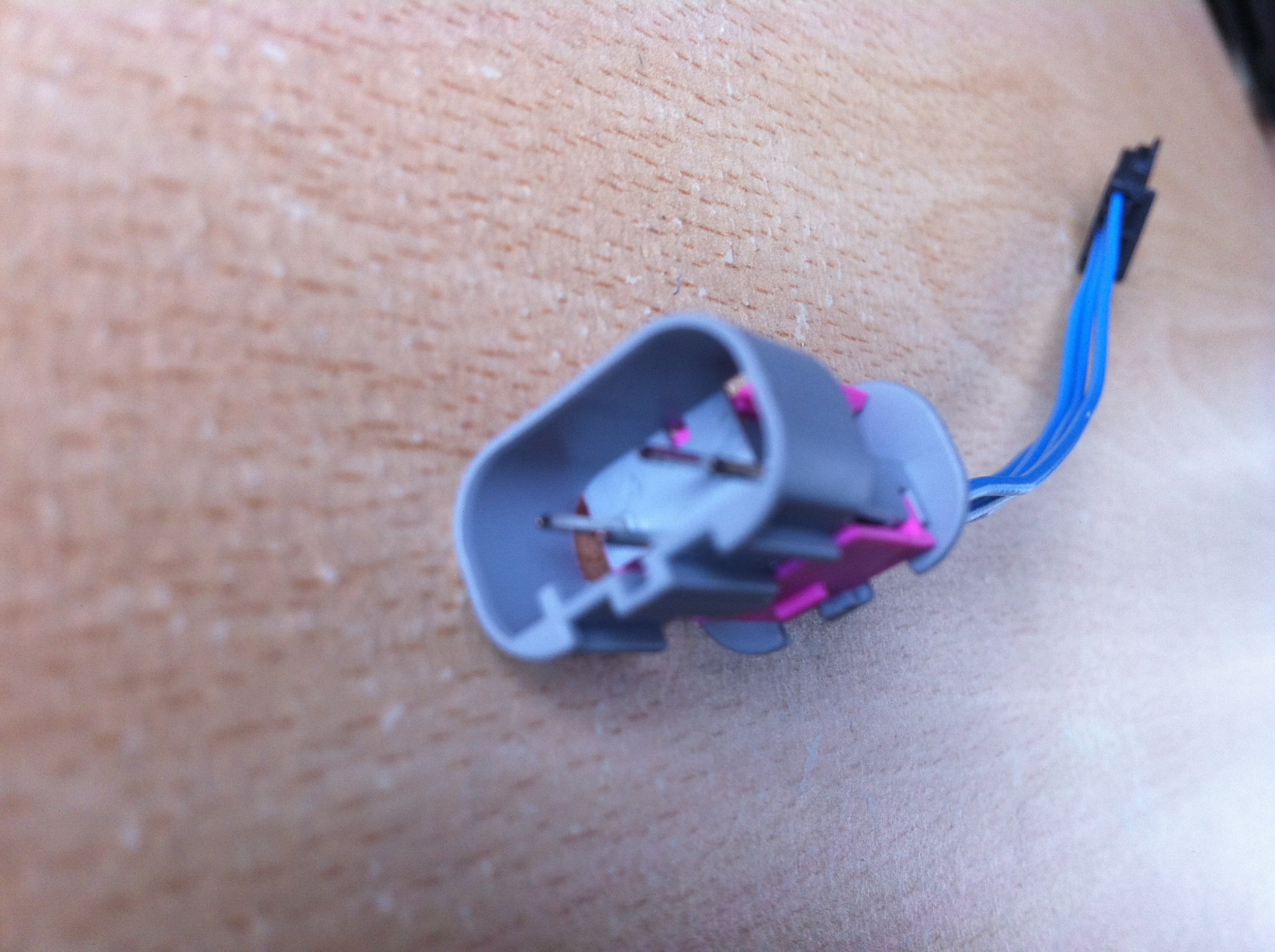

Ok kind of a big problem, the 8 POL connector on the harness does not match the 8 POL socket on the car plug (its the same plug as the car's one and the pins do not align) Turning it the other way around would match but the pins cannot enter the smaller holes.
I think Jas had this problem before? What's the fix?
I have plugged the pins without the plug and all works ok

I made the same mistake you have to turn the blue plug upside down and push the pins in through the wrong end
Old Mar 4, 2012 | 12:26 PM
  #399
sd_dracula's Avatar
Joined: Sep 2010
Posts: 542
From: Ireland
Yeah they actually don't go in due to the small round metal band in the middle of the pin so I took a 5.5mm drill bit and made the other end the same size. The blue plastic stop is holding the pins in anyway so that's cool.

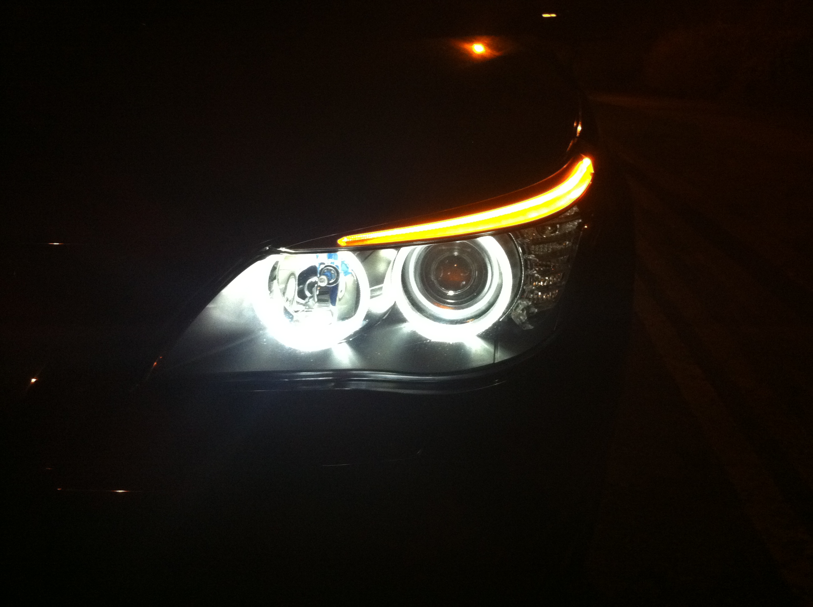

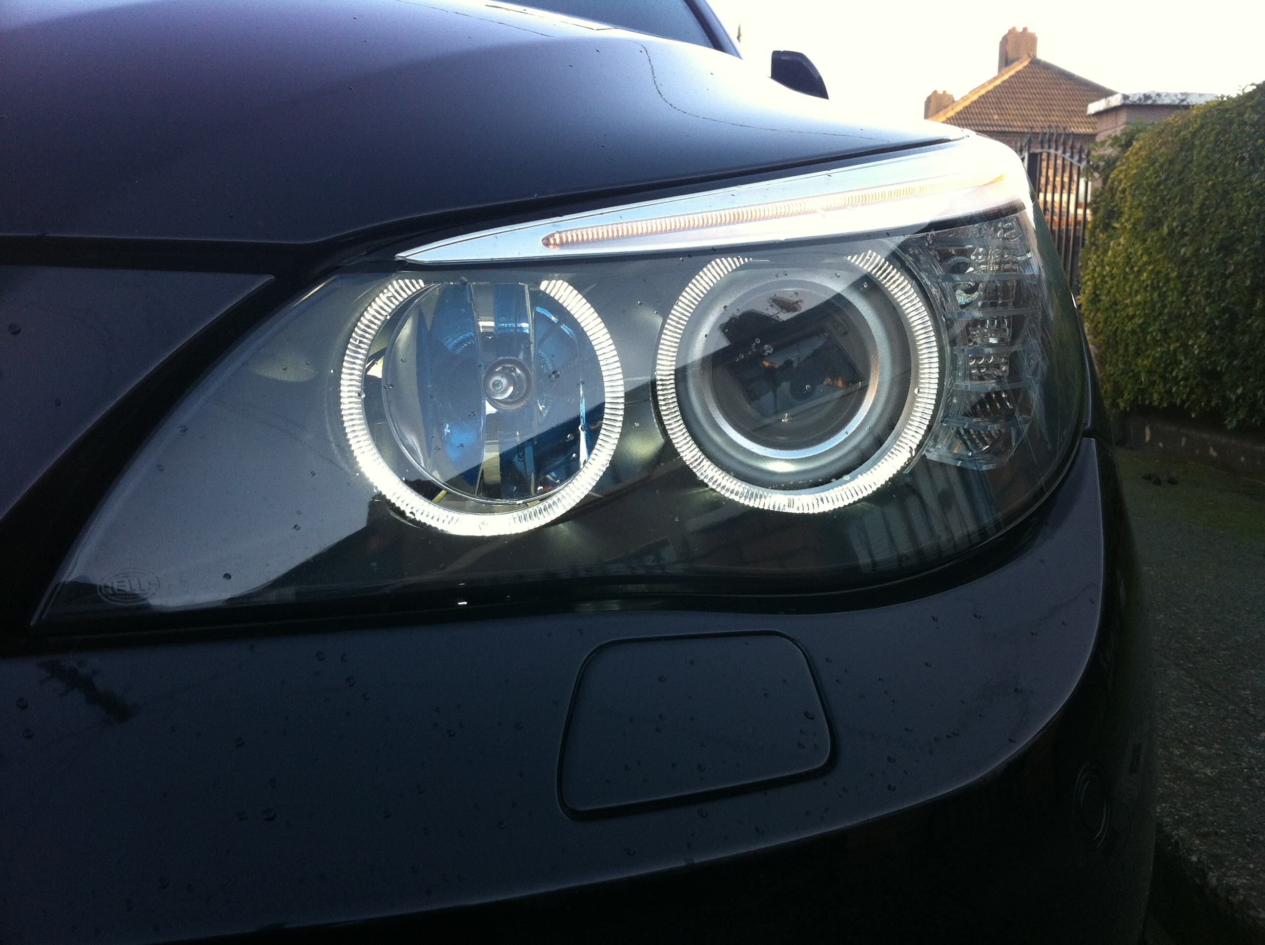

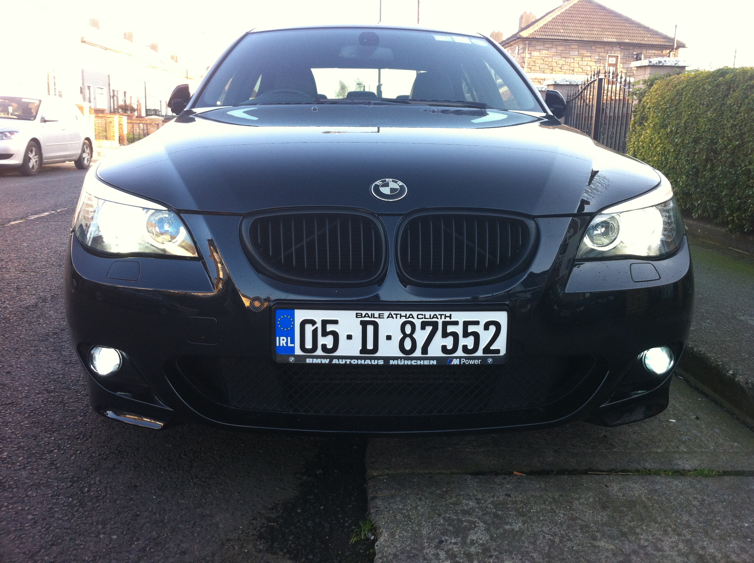

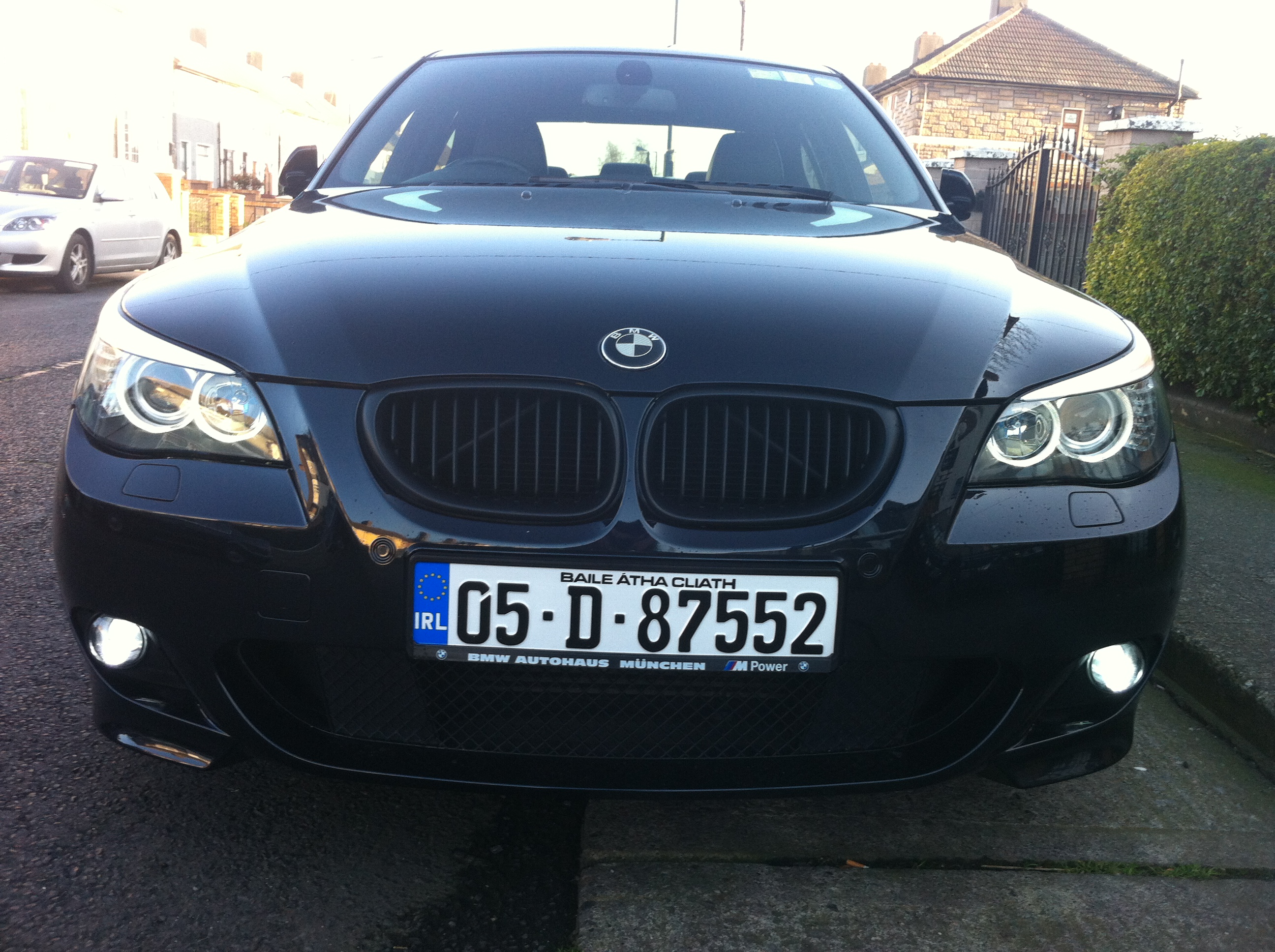

Anyway finally done after spending all of today working on it, and the result:
6000k HID low beam kit
6000k 10w CREE LED AE bulbs
Most importantly, no errors (I did add a 5w resistor to the AE cables and also did not join up the AE cables together)
