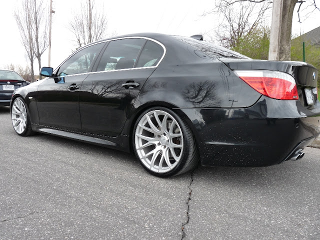

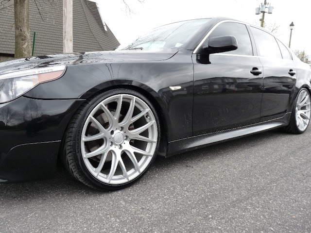

do u think it can go low as these? or lower? i want it to have lower then my current height or maybe the same..

So I installed these myself on Wed. The fronts do not go nearly as low as the rears. you can completely dump the rears if you want. as for the fronts, If you max them out, there's barely wheel gap. For me the front is low enough, so I'm really happy with the look. I had to add 5mm spacers up front as I was rubbing on the strut. My wheel now clears the strut by 2-3mm.
As for performance. I've only had the on a few days now, and all I can say is WOW. Really, not bouncy at all(and the Montreal roads are garbage), stiff and very responsive. They do have the shock adjustment, and I think I've found the right settings for myself.
I cannot compare these to KW, H&R or JIC first hand since I've never had them on the E60. But IMHO these are definitely worth the price.

hi there, I'm very interested in these NEX GT coilovers.
You mention needing 5mm spacers for the front wheels to clear the coilovers... are your Miro wheels 19x8.5" with ET15 offset, or 20x8.5" with ET18 offset?
