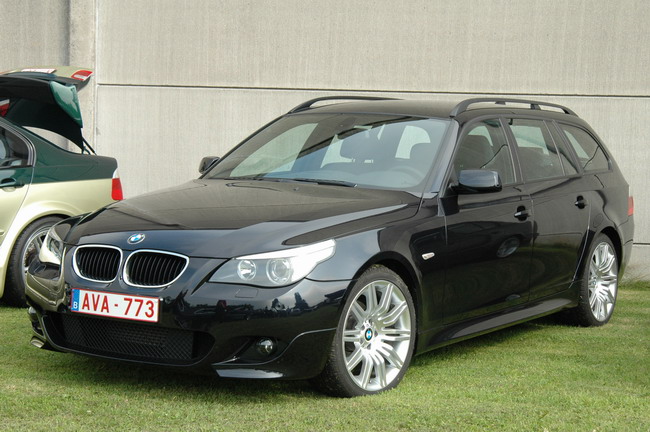

I dont have intention to change the suspension from my sport suspension, i want only change my 135M wheels width 166M original M5 whells whitout problem on my E61. I think is possible exact?

Can you put 9.5Jx19 in the back of your touring? I thought I read somewhere that you have to stick to maximum 8.5" width in the rear. If you use the 8.5J in the rear, you might want to watch the offset. The 166M has +12mm, which is 10mm further out than the 22mm of your 135M wheels. Plus, the 166M is 0.5 inches or 12.5mm wider than your 135M. Your rear wheel arches might need rolling.

Ok, right teory but i dont understand while with the 172M (same size, only diff offset) is possible to mount on E61. I see yesterday with my eyes on Official BMW dealer in italy.
BMW italy put the problem on anterior whells but not for posterior whells.
Other example on this forum.

Damn, I love those clear headlight lens.
The touring model looks really good too. Nice choice alecs!
