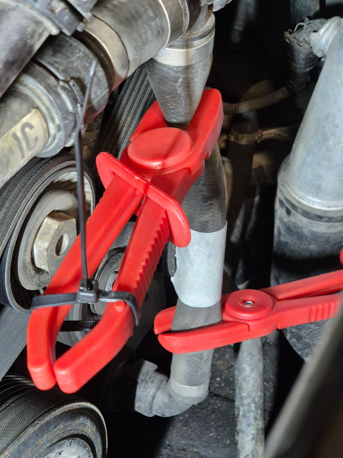

I completed this in December, and it works a treat! The car now warms up to a solid 88-92 degrees within about 10-15 minutes of gentle driving (at about 0 degrees outside temp). Fuel economy has definitely improved.
I used a Mahle/Behr "TH 5 80" and 2 hose clamps.
The process was simple, much easier than the EGR or main thermostat:
  • Remove the slam panel & electric fan for access
  • Put a big tray under the car to catch any lost coolant
  • Clamp the vertical hose above & below where the thermostat will go
  • Cut a section of the hose (I used a PVC pipe cutter)
  • Slide on each hose clamp before forcing the thermostat into the hose (not easy), tighten clamps
  • Top off the coolant reservoir (not much was lost)
I'd recommend doing this if you're replacing the main & egr thermostats, as half the job is getting access.
Big pics...
Fan removed
Hoses clamped (masking tape to show position of tstat)
Done!
