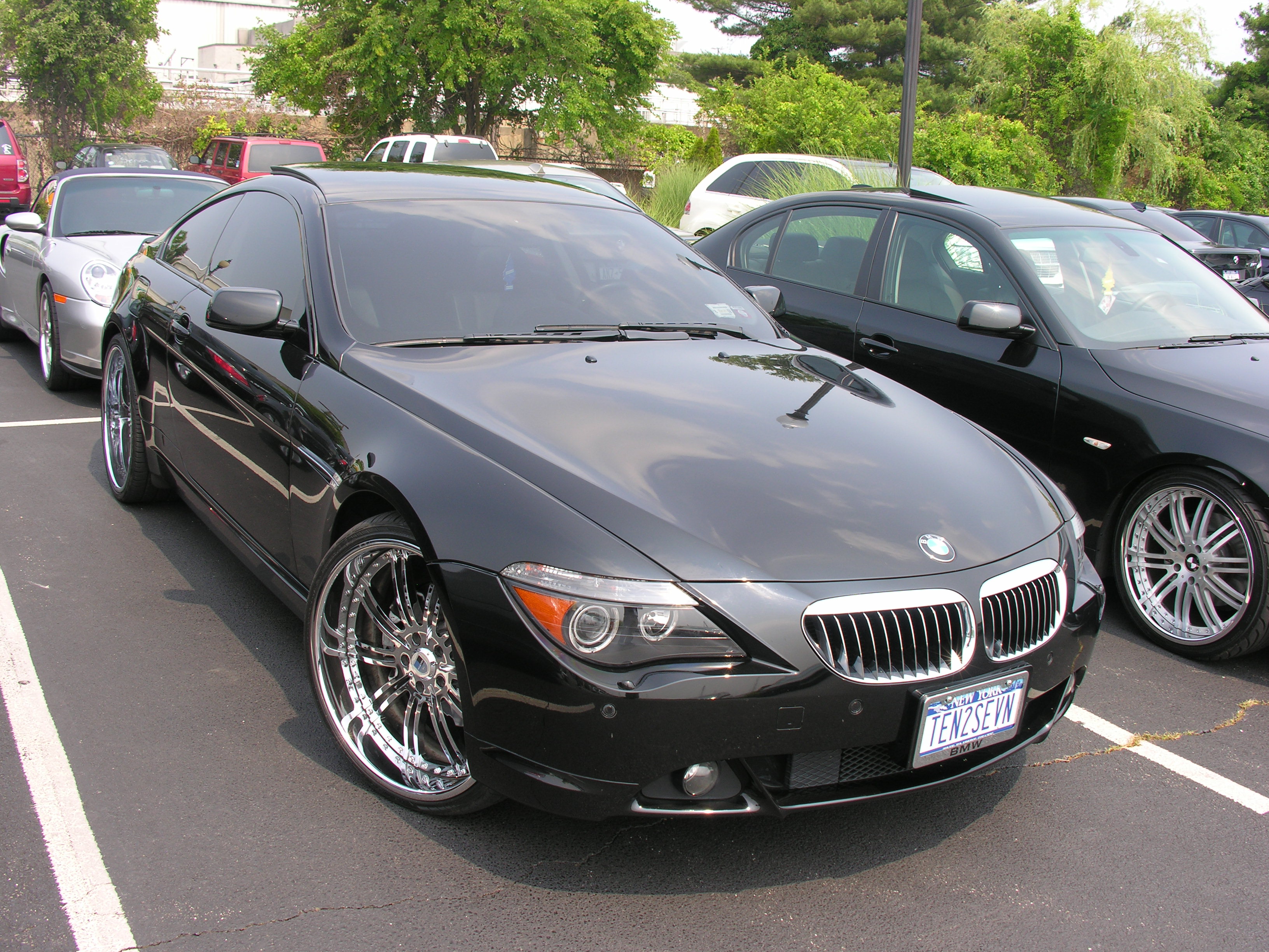

yes please appreicate it ... I found the TIS07 with 20x7.5, 42 offset and 5x120 bolt pattern. I found out that the 530xi has a offset of 43. Would those rims fit on my 530? pros and cons? thanks.
look at that 6 series gotta love the chrome Ashanti's i think

...gotta love the chrome Ashanti's i think
No, I really don't.
You can do as low at ET30 in front with a 245 tire and as low as ET33 in the rear with a 275 tire. That should give you a basis from which to work.
Chrome won't fit, though, in any offset.
Those ones above are not really the correct width. You want 8.5" - 9" up front...and 9.5" - 10" in back.
