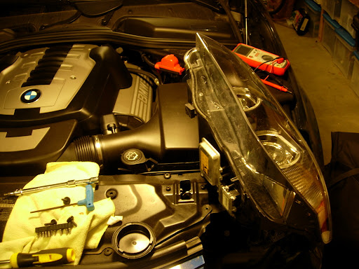

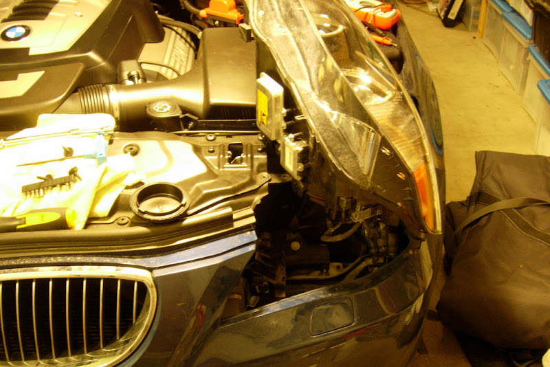

Just came back -- yes there were TWO 8mm bolts holding down the assembly. I now have the light assembly out but can not extend it anywhere as far as John did in his DIY. I can barely turn it because the cord is not long enough.
Now, again, another major missing part to the DIY: How do you access the bulbs? John's photos show him with the dark black panel already removed and him taking out the bulbs. How is something this important not covered??
If you're going to sell something as simple DIY you should have every detail covered and not assume that it's obvious.
I'm going to try this one more time but I'm probably just going to put back together what I can and send the bulbs back for a refund. I already see scratches at the top of my bumper, and this on what used to be a completely flawless car!!!
Anyone with tips on how to remove this large black panel so I can access the bulbs?

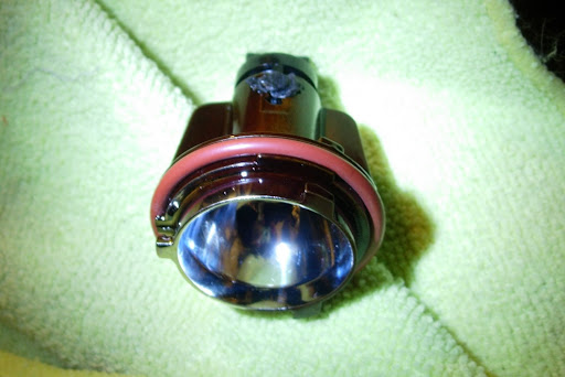

Now I realize I'm supposed to try and take out that dark orange bulb housing. How? I have no idea. The Chinese guy in the YouTube video just reaches in there like it's nothing and doesn't even struggle. I, on the other hand, have now cut open my hand attempting to turn the bulb that WILL NOT BUDGE in any direction.

Thanks for the words of encouragement, or 550, but I'm not even at that point yet. I saw that it was probably going to be difficult to slide those two bottom tabs back in though... Not looking forward to it.
I have turned off the garage lights and have given up for the night. I can't get the orange bulb out no matter what I do. It's like it's super-glued in there and is not budging.

First off, I fully understand your anger as I changed my AE's 2 weeks ago and found it extremely hard to make the switch.
If you haven't already, I recommend taking off the black cover (on the back of the light) before trying to take the light out. It will not come fully out of the housing if you don't do so.
Second, if you have not removed the wiring for the light, the longer black plug will slide up then out and the bottom plug just un-clips (pull hard)
Once you have the housing removed from the vehicle, the orange bulb with twist about half an inch then out. Apply pressure inward (towards the light) and twist. If that's not enough, then use pliers.
You will again find it difficult (and seemingly impossible) to get the large orange bulb out of the small space inside the light housing, but once you turn the bulb 90 degrees with in the housing, it should be fairly simple to wiggle out. The new AE goes right in. Apply pressure and twist the bulb into place, plug it in and replace the light.
The bottom mount for the headlight (closest to the fender) is going to be very challenging to get right. The clip from the headlight will continuously want to go over the washer. I recommend you have someone help you out with a tool to hold up the washer as you apply downward pressure with the headlight and slide it in.

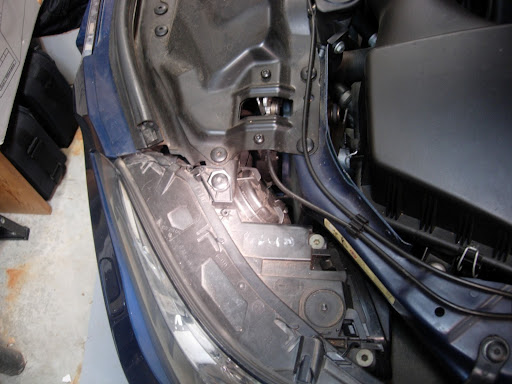

Joined: Feb 2009
Posts: 664
From: Portland, Oregon, USA
And it's behind here:
