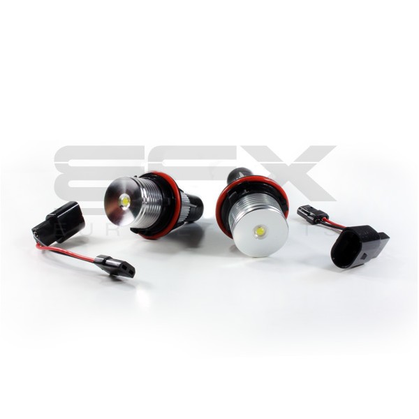

I have same 2008 528i order on Eb H8 didn't fit.
Sounds like my story.
They want to send my the 5W, please see image and hope any of you will know if they will fit my car.
Thank you
Thank you
