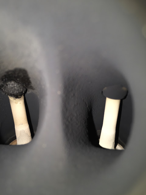

Checked my valves and it looks like a sleeve on cylinder 4 is bad

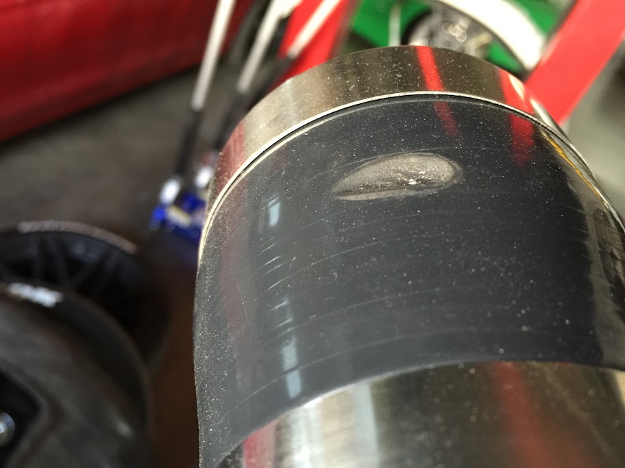

Found some wear on the silicone reducer running to my intercooler, I am also happy to report that it wasn't filled with oil.
