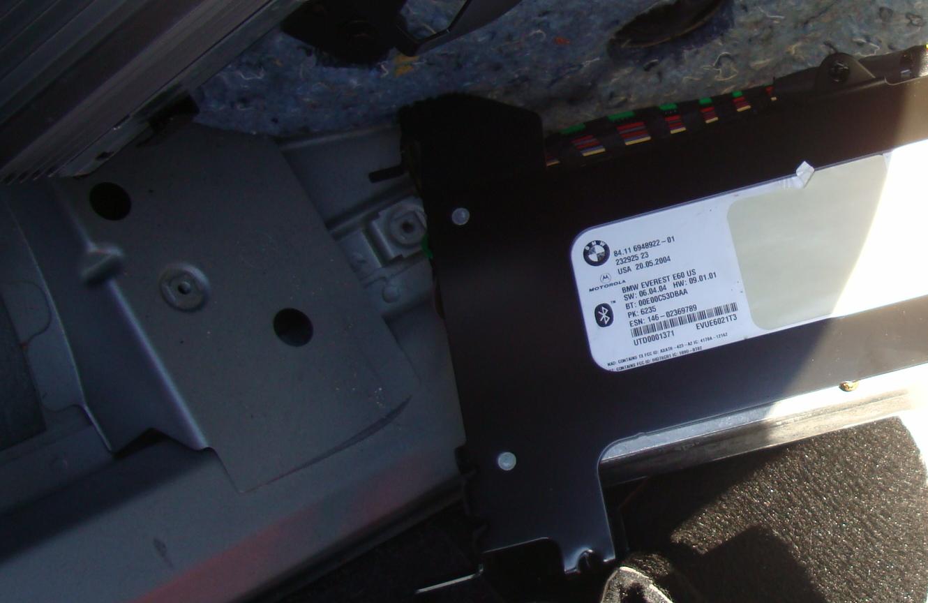

Huh. I don't have that in my glove box, and don't think I have seen that before. See if you can check that part number and verify.

Ok, only because I'm not storing any dead bodies, Unless drained of blood, and cut up, they can be a little heavy to remove. Taken couple minutes ago.
Got the Bluetooth symbol there.

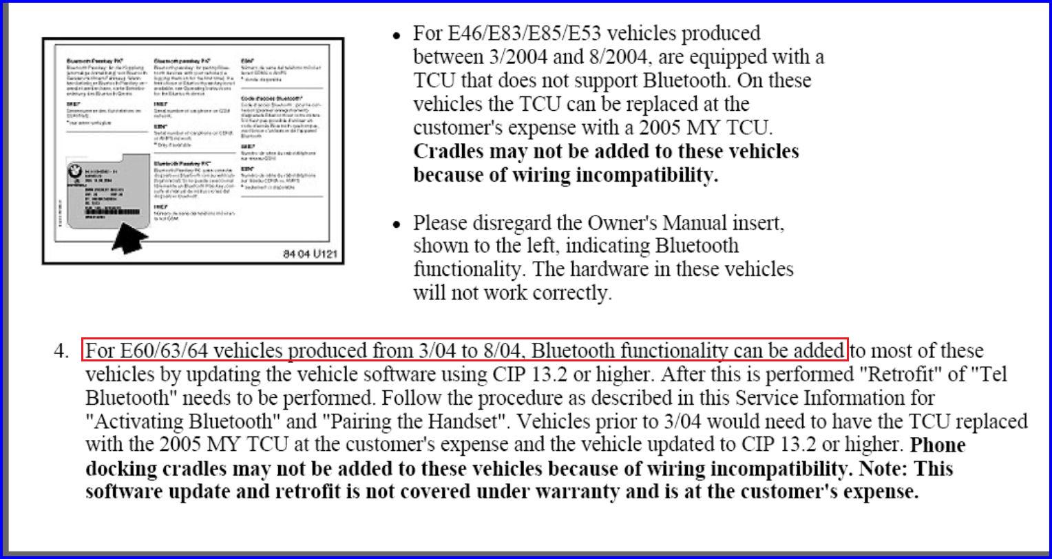

plus....
Bluetooth.pdf

I guess you should be okay then!
