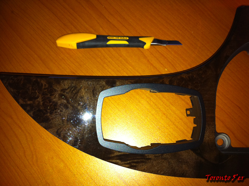

Originally Posted by Georgieb
The end result was a perfect match. Once I was satisfied with the way the bezel fit I removed the tape and started to take the center console in the car apart. For an excellent read on how to do this simply roll back a few pages in this thread to Peter's pictures and info.
Sorry to drag up a rather old post, but does anyone know the part number for the trim bezel that's shown here? NEVERMIND ON THIS QUESTION. I FOUND THE ANSWER HERE: https://5series.net/forums/e60-parts...2/#post1414003
Also, does anyone know if the CIC controllers used on vehicles produced most recently (i.e. X3/X5 right now) will work with the CCC system? I haven't compared the wiring diagrams on them, but I was thinking they might.
I have access to one of the new controllers for a very low cost and am installing the CCC system in mine, so wanted to see if putting the new style controller in is an option.
The newest style no longer has this "shroud" as I will call it, but I'm fairly sure you can swap out this trim bezel with the new style one.
I have seen members here trying to buy this plastic trim so I am assuming its essential to hold the controller parts in place. Probably the newer cars have some other way to hold the controller machinery.

For anyone else looking for this part:
RealOEM.com BMW E63 645Ci Center console/mount/trim
Part number 51169169999
