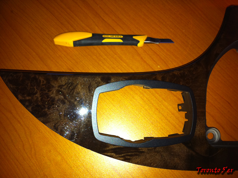

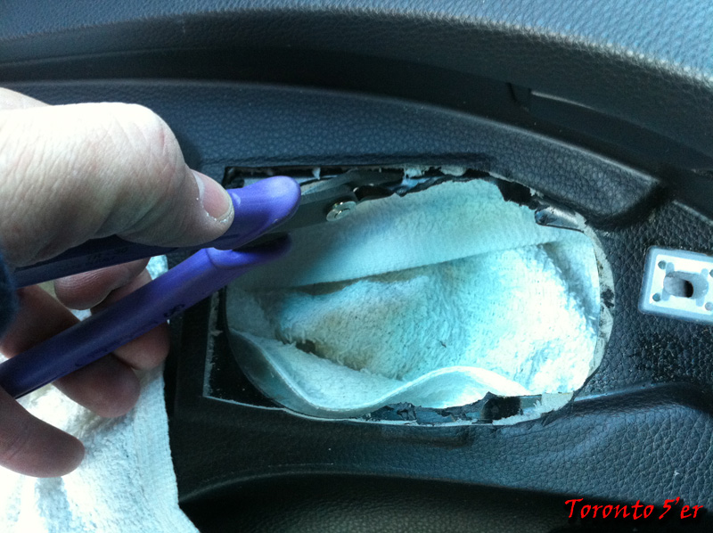

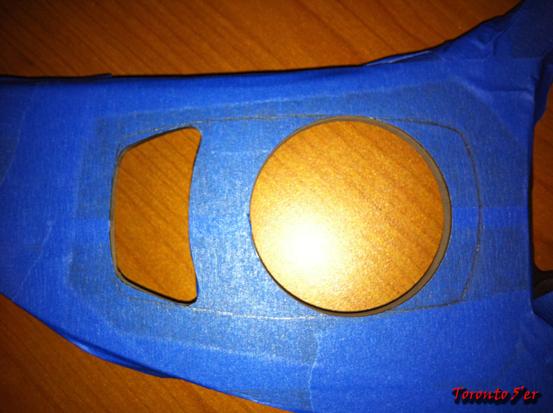

I have taken a plunge and ordered a CIC unit for my LCI 5 series. I am a bit worried about centre console change for new controller, I want new controller but don't want to replace the whole centre console for it. I heard some people saying you can cut the trim and fit the new controller but need to buy a bracket, guess this is the route I will take. However I am not sure what else needs cutting under the trim.
AI001,
Given that this is a "monster" thread its understandable if you missed the information. You can cut your center trim to fit the new controller as others including myself, have done. Here's the page I posted the information on..and a few pics.
https://5series.net/forums/topic/994.../page__st__360
Attached Thumbnails CIC Retrofit Installation LOG-idrive03.jpg   CIC Retrofit Installation LOG-idrive09.jpg   CIC Retrofit Installation LOG-idrive05.jpg

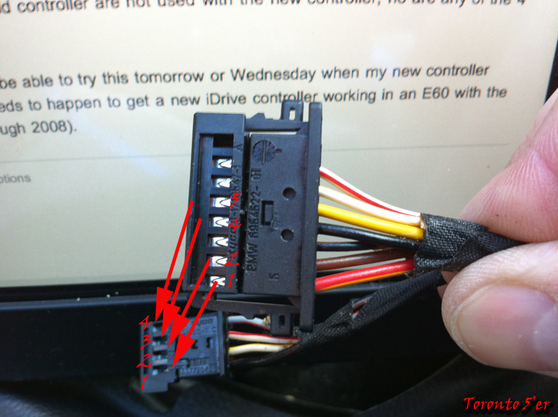

Thanks for your input Georgieb, looks much better. I will do full retrofit definitely including the controller. btw did you need any bracket to mount usb port in the glovebox, wouldn't that go besides aux input (which I have on the rear side of centre console between vents)
There is an insert for the USB connector which is used in the same place that your flashlight currently sits. I decided to just let my port hang in the glove box as I never did get around to purchasing the USB insert mount. I can't remember what the part number for this bracket it but I'm sure its hidden with this thread somewhere.
Would my car which is MY 2007 LCI E60 need any programming to get started. I know few people say its straight swap (except nav and voice will need fsc code) but others say you have to change your car build date to newer date? Leaves me a bit confused.
If you are referring to the iDrive contoller swap, then I do not believe additional coding is required although the wiring harness and conductor pinout will have to be changed. If you are refering to your CIC, then coding is definately required. It may be best that you ask Patryk's advice on this.
Cheers
Attached Thumbnails CIC Retrofit Installation LOG-cic04.jpg   CIC Retrofit Installation LOG-usb_location.jpg   CIC Retrofit Installation LOG-idrive07.jpg

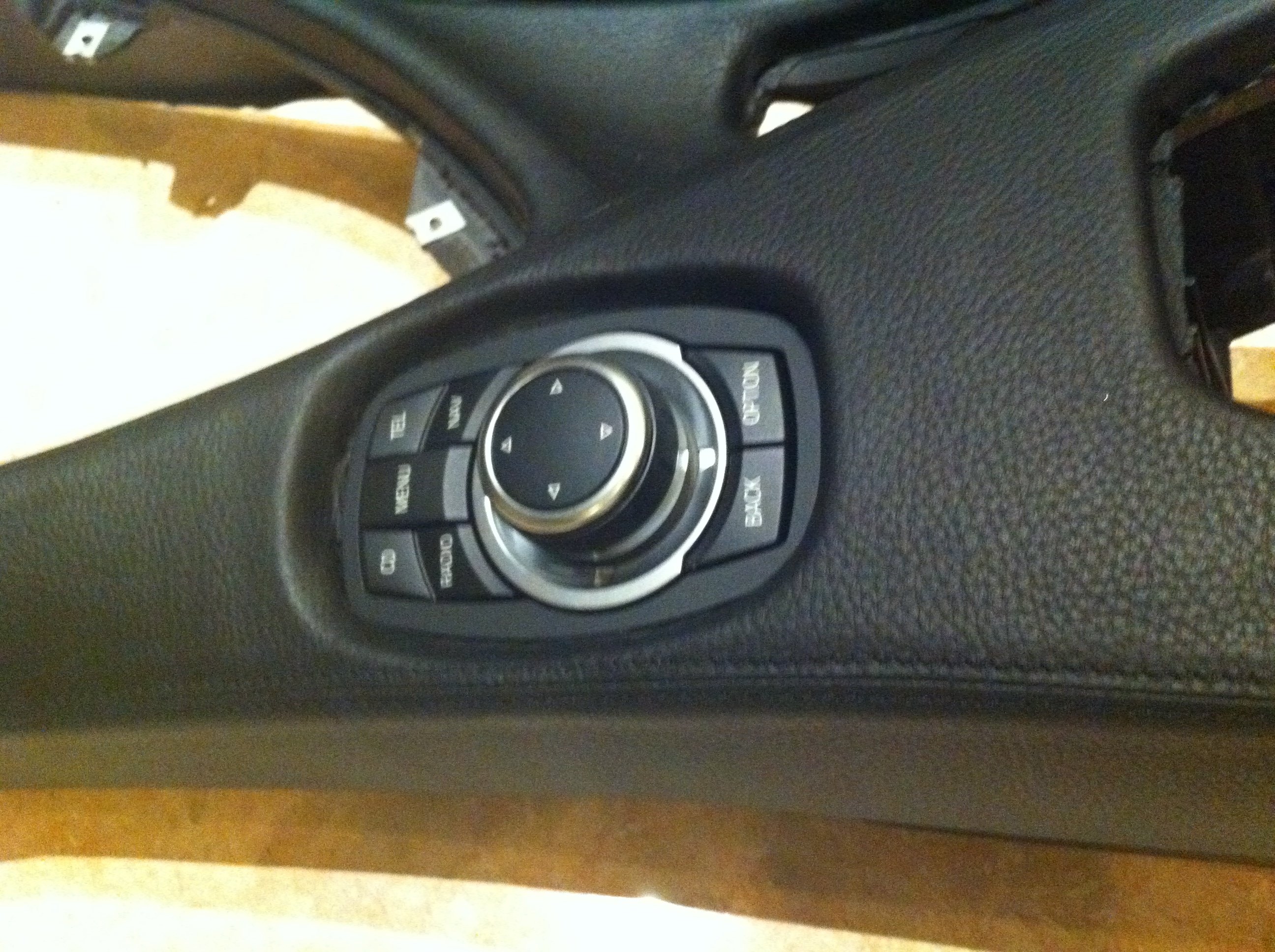

Doing the lot, including the new iDrive controller. As my interior is full leather anyway, its worth to mod the center console for the new iDrive controller. Also with the new a/c control panel, and combox with 6fl. Havent really got the chance to try everything yet. Patryk is again very helpfull and efficient in doing the remote coding.
