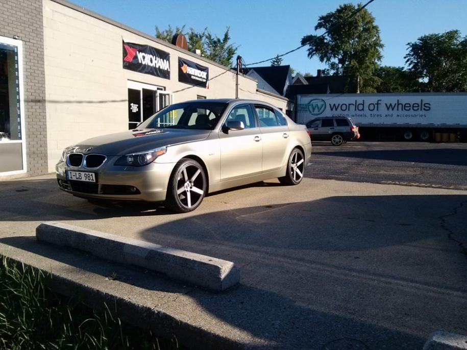

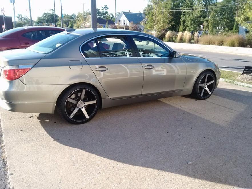

I have a 2006 530xi stock non sport, with 19x9.5 F&R 255/30 tires. I was wanting to go with the H&R springs Front Lowering -1.4" Rear Lowering -1.3"
Just want to make sure it will not rub. thanks to all for the input.

looking at the pics, the rears should be fine, but the offset on the fronts seem pretty close, might rub the arch under load, could just be the angle.

Yeah. Some people are getting away with 255's on the front on non-M cars. All depends on the size of the wheel and offset. The OP will probably be okay on 19's provided the offset isn't too aggressive. For my car we had to install the wider "M" fenders to make the 255's fit comfortably. That was on 21" wheels with lowish offsets though.

Thank you for the info i might try and get them put on in the next couple weeks, i will post pics when i do. im pretty surre its a higher offset since its awd.
