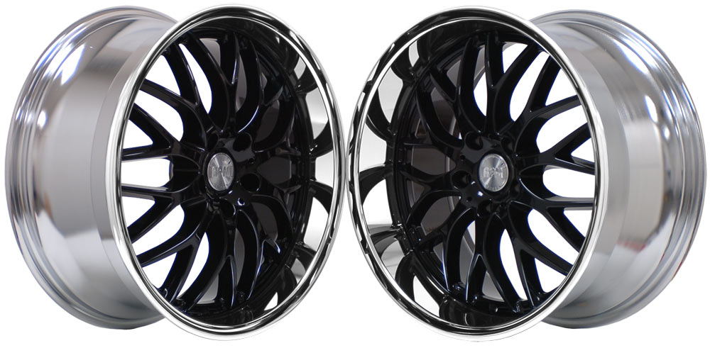

Hey guys, so i am waiting for my Saphire black04" 530i prem package to get here! No mods on it... I want to upgrade the wheels, With 20's do i need to lower the car or do something with the springs so the car does not look awkward, or will it sit nice without any changes. Also i heard about rubbing with 20's is this true? I'm going with these beautiful wheels here i think. I know 20's aren't as comfortable as 19's but they sure do look better..lol
20 x 8.5(Front) +20x10(Rear)
245/35/20(Front) + 275/30/20(Rear)
Chrome Lip. 2.5 front and 3.5 back

Depending on the offsets of the wheels and the brand of tires you use, there's a chance you'll rub on the rear fenders (easily fixed by rolling your fenders though). I would definitely recommend lowering! Aftermarket wheels make the car appear to sit like a truck w/o a drop.

What are the offsets on the wheels?
If your car has the sport suspension it will sit really nice with 20s... my car almost has 0 fender gap.
You will not rub with 20s if you use correct tire sizes and have the correct offset.
"20s are not as comfortable as 19s" does not make sense... the ride quality will actually be the same because the sidewall sizes are the same on the 19s and 20s.
