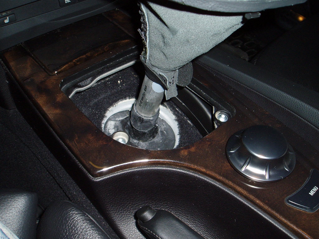

This weekend I changed shift lever (no 6) and bearing (No 7)
http://www.realoem.com/bmw/showparts.do?mo...hg=25&fg=05
Original shift lever art no: 25117521444 was changed to short shift art no: 25117546373
And new bearing art no: 25111220600
The change was not that complicated. About 2h work, on the garage floor.
To do the change according to the book, you are supposed to remove, exhaust, heat shields and drive shaft.
With thin arms with four joint you are able to just remove heat shield bolts and squeeze the arm in between everything
This operation is needed to remove the circlip (no 12), to be able to remove shift lever from the top.
This operation is strongly recommended.
The shift throw is just noticeable shorter, but the great advantage is the "new car" feeling you get from changing the bearing.
I will attach a couple of pictures during the day.

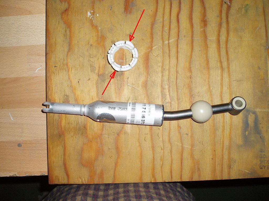

The bearing is like $6. It helps to have a new one available, as you could likely crack the old one while you're removing it, and seeing the part out of the carrier will help you understand what we're talking about. Basically, you have to bend/crack the two "fingers" that have tabs going into the metal carrier, then stick a screwdriver into the slot at the 6 o'clock position and rotate the bearing clockwise a bit to unlock the tabs. Then the assembly just pulls right out. To install put the bearing on the shifter first, then put the assembly into the car.

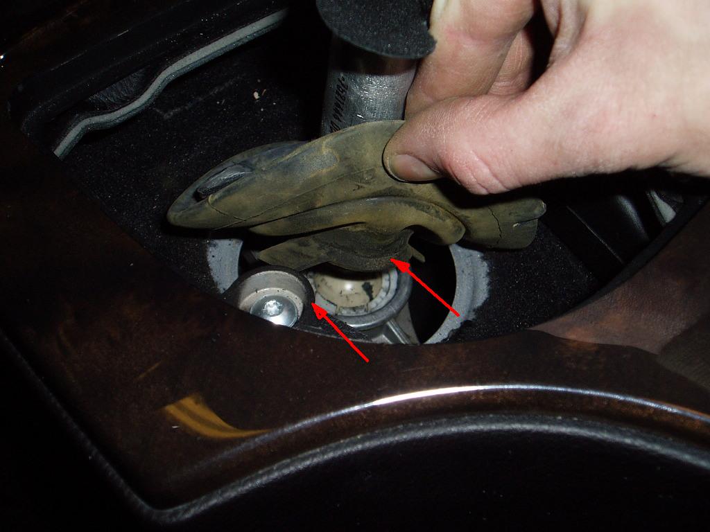

Stick and bearing. Arrows point at the small tabs mentioned in previous post.

This is where to put the small flat screw drivers, to release the bearing from the aluminum carrier.
