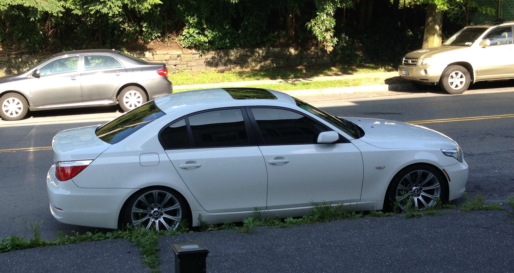

Finally got my 'new to me' wheels put on the car this weekend. I got a nice set of 166 OEMs with new Falken 452 tires (F: 245/35-19, R: 275/30-19).
I also got 35% all-around window tints from Lorenzo's in the BX.
I was wondering what spacer width I need to go with on the rear. I think the fronts are OK. For the rear, I'm not sure if I measured correctly, but there is a distance of 1" between the wheel surface and the fender exterior. I'm on stock sports suspension.
Anyone here running a similar setup?
tia

With 10mm spacers on rear you should be safe. (no rubbing if those are 9.5 inch wide)
You can also consider 12mm but i don't guarantee for no rubbing. (it shouldn't rub but ..)

Yep, they are 9.5" width. Thx

I got 12.5mm on my rear...no rubbies

I have 15mm on my 2008 535i with 166 rims, no rubbing or issues
Looks great and doesn't stick out, nicely flushed with car body

[sup]12mm with sports suspension. some of those guys don't rub cause they got upgraded suspension, but 12's will rub on a good dip. I am going to get my rears rolled.[/sup]

12 or 15 should do the trick...
you can always measure the gap for yourself as well though...here's how
