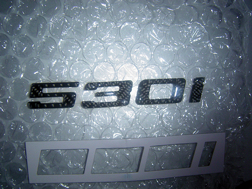

I replaced my OEM chrome 530i badge with a caron fiber one i got from ebay ($13). its real carbon fiber laminated with what appears to be silicone, not epoxy. they're flexible and is a little larger than the stock one. i think it looks great. check out the installaion pics... took about 10 minutes to install (including taking pictures).
orlee
Carbon Fiber badge:
530i Carbon Fiber badge / emblem :)-1.jpg

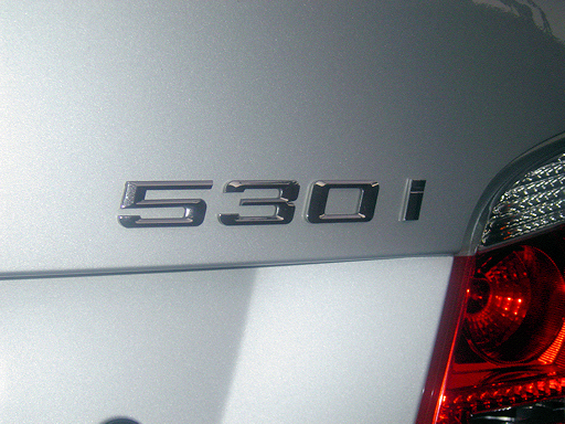

OEM badge:

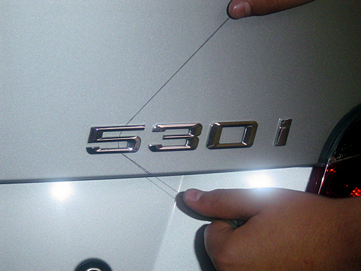

Using orinary sewing string to remove the OEM badge: (dental floss would work well too)

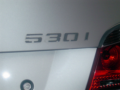

Left over goo... i used windex and some elbo grease to remove it. I didnt want to use any harsh solvents.

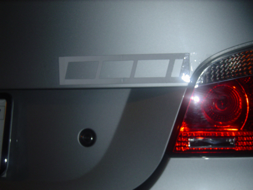

Taped on the included stencil

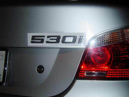

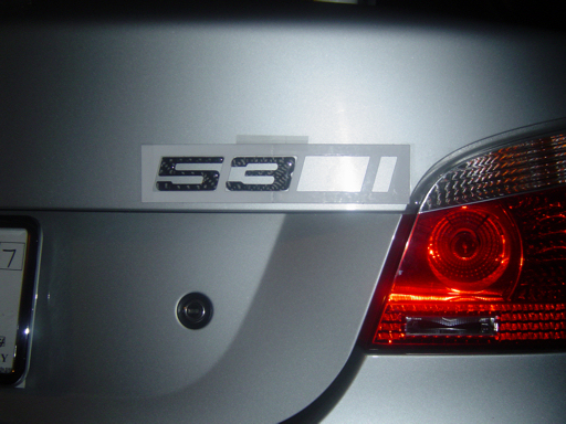

Applying the carbon numbers
530i Carbon Fiber badge / emblem :)-6.jpg

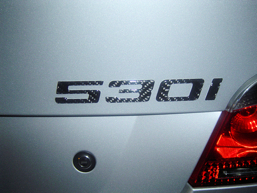

All done...
530i Carbon Fiber badge / emblem :)-7.jpg
Final result!
530i Carbon Fiber badge / emblem :)-8.jpg
Hope this helps anyone that might be considering to do this...

nice that stencil made things much easier
