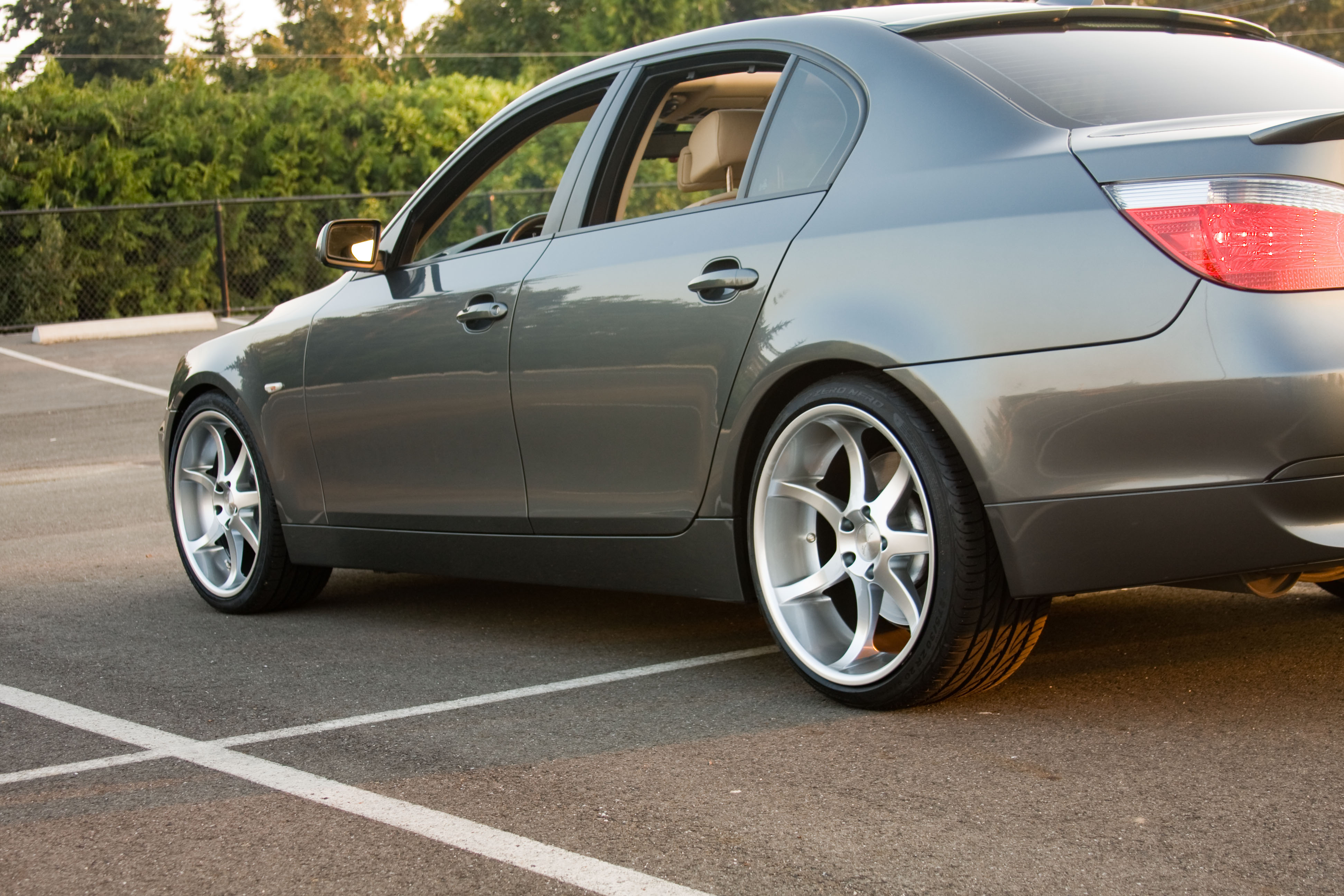

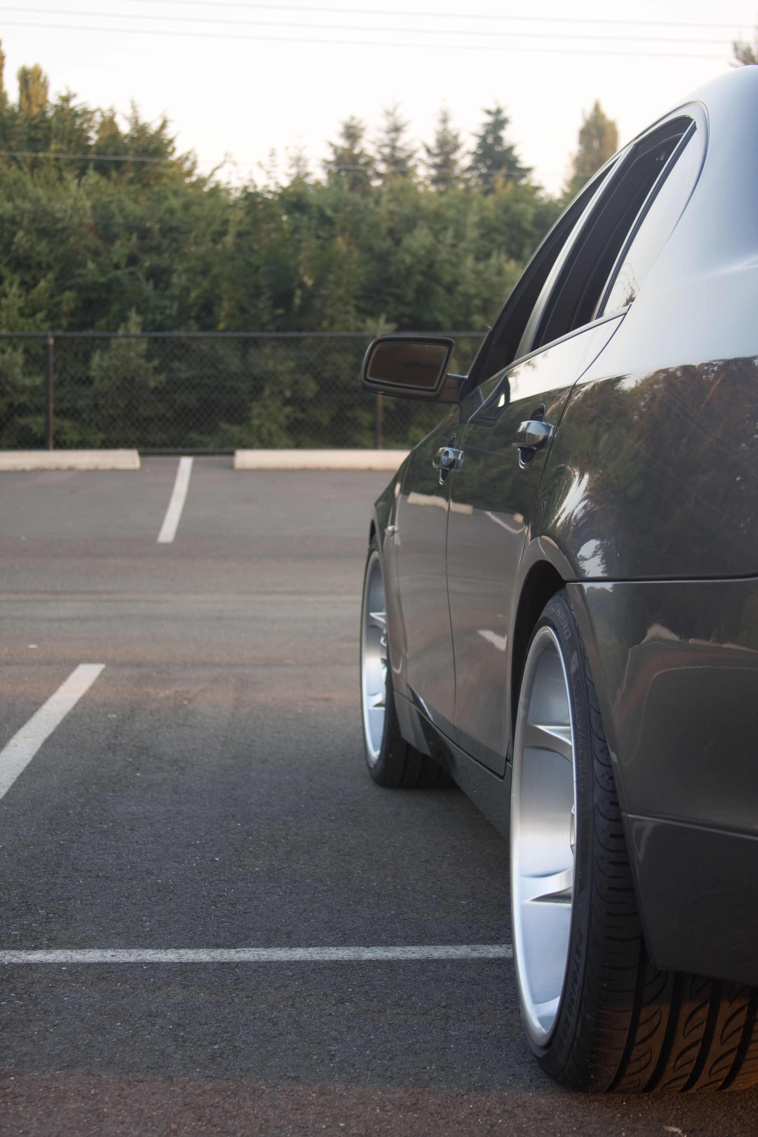

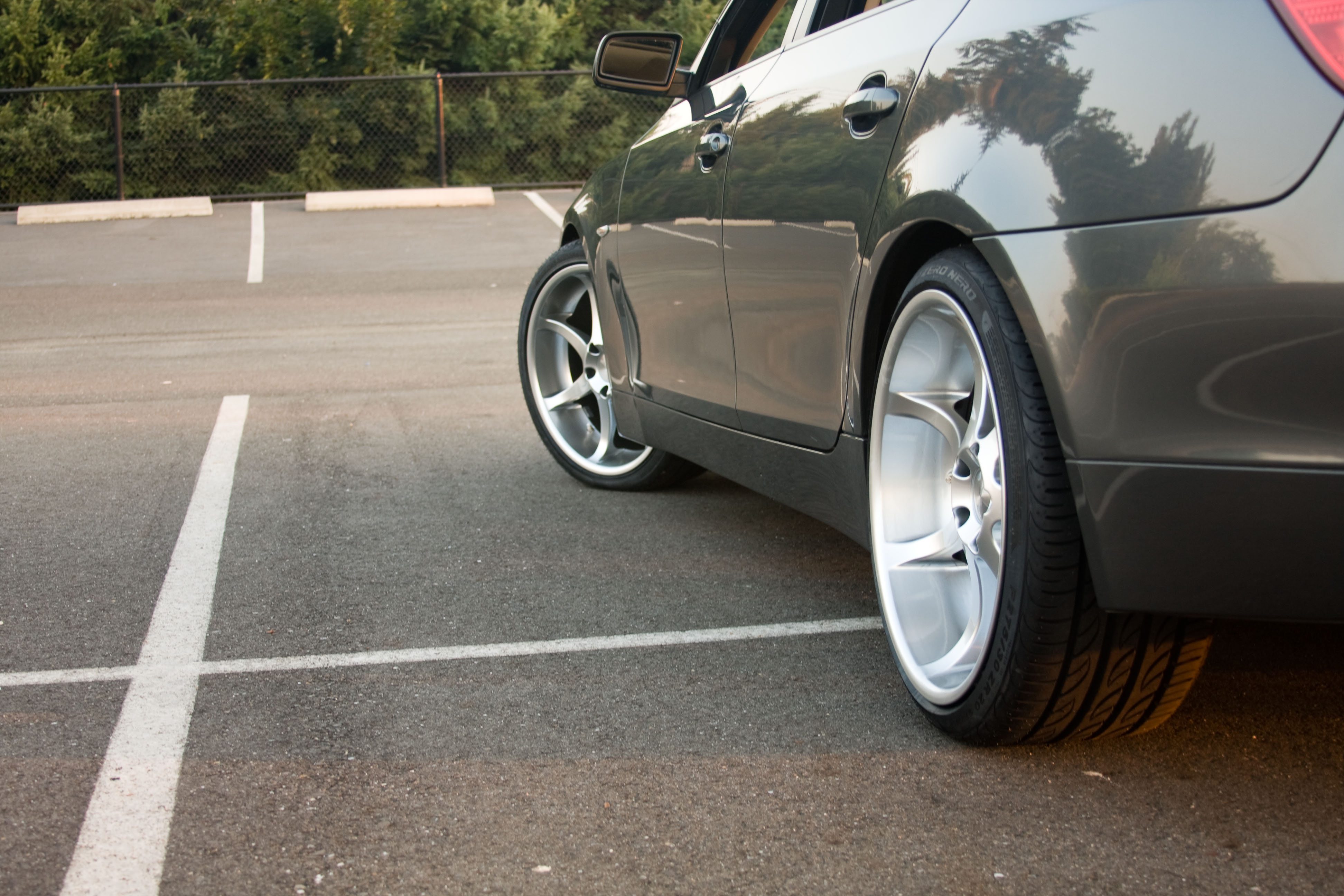

Well I made the plunge and here are my new rims
