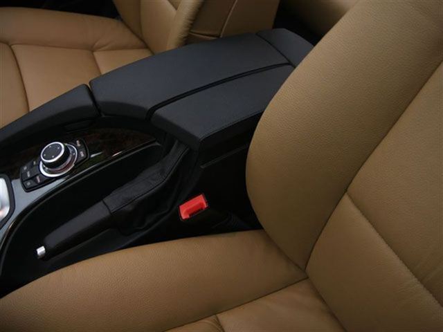

Hey, so has anyone removed the center console to run an AUX cable from inside the armrest to bring it out by the passenger footwell? I leave my phone by the NAV screen right now, and will be soon getting a mount that goes by the center vent (Proclip), so then I would connect the cable to the phone to listen to music. I'm usually streaming Songza and not music that's on the phone, and would like my phone to be visible.
I just did that on my 3 series, and it wasn't too hard. Getting the center trim piece out wasn't too hard (the one the gear shifter is in), and I ran the cable under that, past the shifter, under the ashtray and out the side, and then bring it up to connect to my iPhone. Luckily, inside the armrest, there isn't a permanent hard plastic tray like in the 5 (it's just a rubber one, so you can slide the cable under it, and into the cavity below.
Was thinking of doing the same with the 5 series (I have a wagon, but I believe the center armrest is the same? See pic below), but the center piece not only has iDrive, but it looks harder to remove.
Wondering how I can get the AUX cable to come out of the armrest from underneath...
