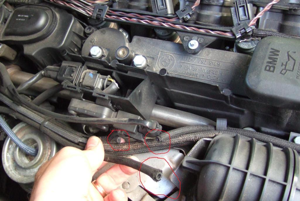

I have 102,000 miles on a 535d and occasionally lose the small turbo boost. It always runs fine when cold but after it has warmed up there is no power until ~3000rpm. I have to resort to manual shifting pulling out at junctions it is so slow.
Having read about a split vacuum hose, I had a look and found this...
https://5series.net/forums/uploads/m...3442_thumb.jpg
Any thoughts welcome - what these are and should they be open ended hoses?

No this is my problem also. replace or repair these and you will get your small turbo back. What is happening is you dont have a small turbo when this one is broken. So you will get a big kick at around 3000rpm when the big turbo kicks in. I have ordered some silicone vacum pipe and my mechanic is going to replace all of them. My car is still running a bit rough but i have my small turbo back and that is with two broken pipes temporarily repaired with some brake bike.
Will try and take a couple of pics tommorow to show you the repair and i think it is one of the pipes in the photo.
bmw will charge about £9.00 per hose. To be honest the quality is not great and the heat in there is very hot. So i am going to try some silicone hoses.
Cheers
Fraseman

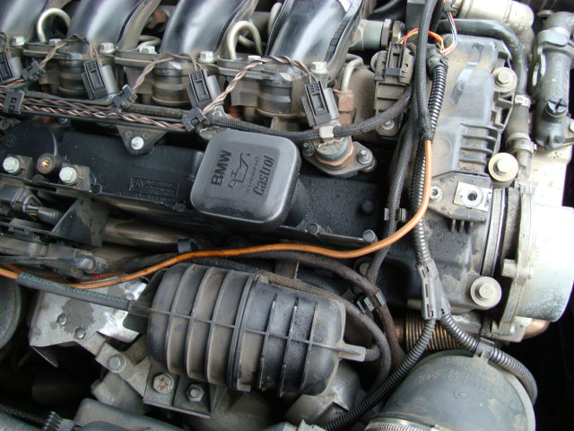

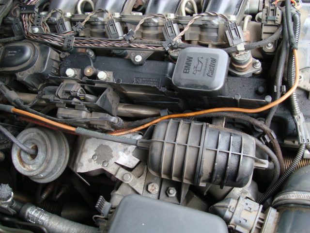

Hi Mate,
Just wanted to see if those two images downloaded! Ok what you see in the pics is the repair of two vacum hoses until we get the vacum hose and repair them full length. The rubber hose you see attached to the round black plastic thingy was also put in temp. So this pipe was originally going from the black ball to a little plastic 3 way joint. We put rubber hose on both ends and joined it with brake pipe. The other pipe has been replaced from just under the bulkhead to the front of the engine area.
One of these or both these repairs brought the small turbo back on. However, all the pipes are rotten. My car has done 210,000 miles!
The reason it was only a temp repair was that we need to get hose and the bulkhead area will have to come out. This is not a big job but without the correct pipe we just repaired the broken ones on the top. When fully replaced i hope my rough running has gone.
I will include pics of the job being done later in the week.
cheers
fraseman

Thanks Fraseman,
I am reassured that you have 210k miles - that is great news, I am ony halfway there!
Thanks for the pics too - gives me an idea of what I can do until I get it to the garage. I hope your silicone pipes work well.
