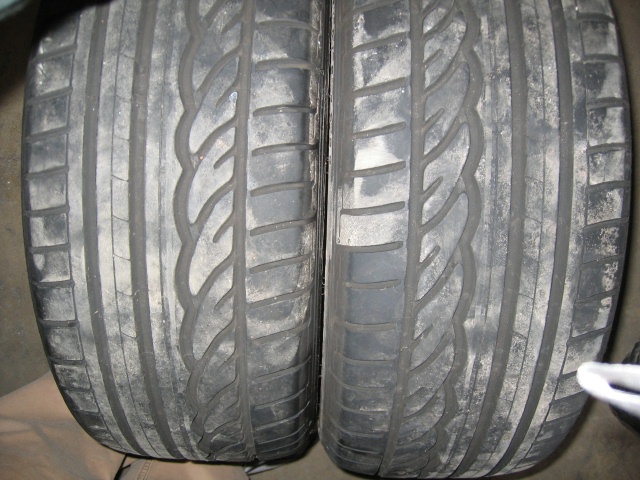

Originally Posted by Ricracing' post='259913' date='Mar 25 2006, 01:13 PM
Tires that have directional sanctions always have big arrows on the side.
The Dunlop DSST tires do not.
They are crap anyway. Go for Continental or Michelin non RF's!
You are correct - you can rotate them - no way you will get the same tread pattern at each corner. For those that can't picture it (sorry) - I took two pictures (exact same result).
Thanks
Attached Thumbnails Switching to OEM tires from winter-img_0907.jpg   Switching to OEM tires from winter-img_0906.jpg

Just put the ones with more tread rear!
Edit:
Hmm, you seem to have 275's rear and 245's front -
just forget my comment.

Wait a minute these are not directional tires?
Note: No I have not tried to look for the big arrow yet.

All tires are marked when it makes a difference but a general rule is the tread pattern and the direction of rotation should help facilitate water evacuation from the middle of the tread to the outside of the tread.
example- )))))) tread pattern as viewed from the top view should roll >>> because the center of the pattern hits the ground first and pushes the water to the outside of the tire as the tire rotates and hit the rest of the pattern with the edge hitting the ground last.
