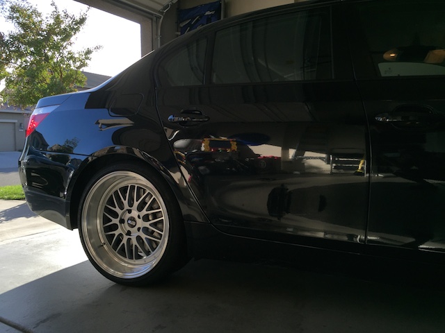

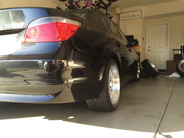

I just got some wheels off CL. The previous owner had them on an E39, so I thought I would have no fitment issues, except for adding hub rings. I bought them without checking the offsets. Looks like it has a 3-series offset?
20"x9" ET30, 245/35/20 tires
20"x10.5" ET35, 275/30/20 tires
What spacers do I need to fit these with zero rubbing? I have sports suspension, and I don't want to roll my fenders.
Anyone selling used spacers at a good price?
Attached Thumbnails STR 601 wheels, need help fitting these on E60-img_2730-copy.jpg   STR 601 wheels, need help fitting these on E60-img_2731-copy.jpg

20mm all around should be good

I'm considering 12mm front and 17mm rear, to be conservative. Should this work?
Considering getting this set.
BMW Staggered Wheel Spacers Kit 2 12mm 2 17mm Thick w 20 Lug Bolts | eBay
Old Nov 16, 2014 | 09:37 AM
turboawd's Avatar
Posts: 3,652
My Ride: 2006 BMW 550i
so that will get you to 18 front and 18 rear. sounds good.
