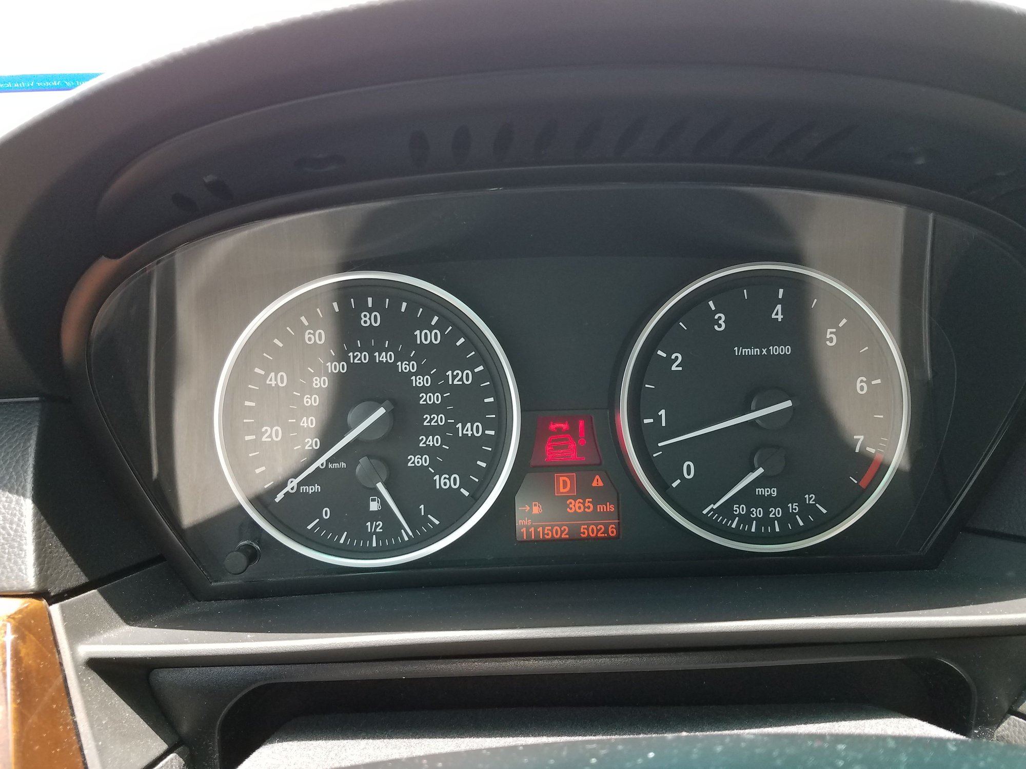

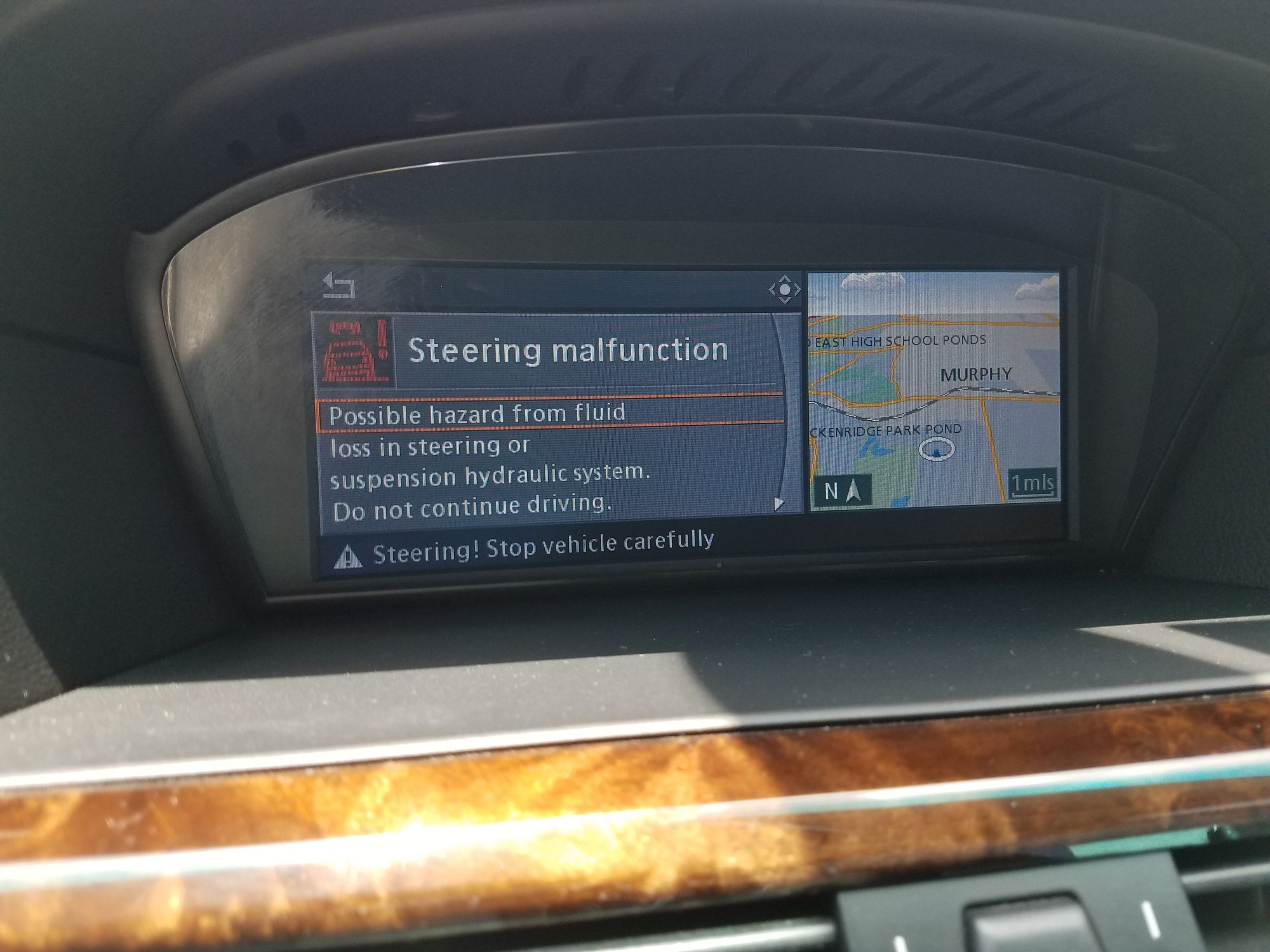

Hello, just experiencing this for the first time in all these years. Yesterday afternoon right after starting the car and pulling out of the driveway this Steering Malfunction warning appeared. I pulled over turned off the car for a few seconds, and it still remained. A few hours later upon starting, it didn't appear anymore. This morning it reappeared. So I took it in to my indy. He hooked up his computer and reports that it is a faulty oil level sensor!!!
Why would an oil level sensor throw a Steering Malfunction code? He said that to replace the part, the oil has to be drained. So might as well get the oil and filter changed at the same time.
Anyone else experience this?

I reconfirmed and it is the Oil Level Sensor! I know that sounds strange, doesn't it? Well, he is pretty sure about it, since he plugged in the computer to get the fault code. He explained to me that the Active Steering System can throw these types of erroneous codes.

I left the car with him for the entire day to check. Indeed there is leak from the seals of the rack & pinion! I was hoping for some better news. The car was involved in a frontal collision recently, and I'm wondering if that could cause this, or is it just a regular wear and tear?
The price of the parts seems to be WAY up there!! The Indy is saying that I can drive it for a little while adding power steering fluid occasionally. Funny, I didn't hear any funny noises, clunks or tightness in steering.
Anyone go the non-OEM route, or do I have to swallow this HUGE OEM pill? I do see rebuilt ones on Pelican Parts and AutohausAZ.

So it wasn't a low oil level problem, but definitely a low power steering/dynamic drive fluid level alarm. If it is just a power steering seal leak, then follow your mechanic's advice and keep adding fluid and monitor the rate of loss. Also, try adding some power steering stop leak to the fluid. It might recondition the seals somewhat and slow/stop the leak.
