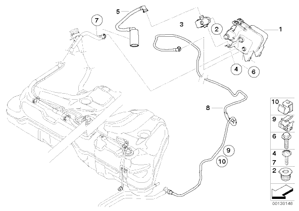

Was there a specific code from the reader?
I've had the increased emissions problem for a while. I've found out I need to change the
activated charcoal filter (item 1 in the picture), for this to go away. If I remember correctly the code for this was 1439.
