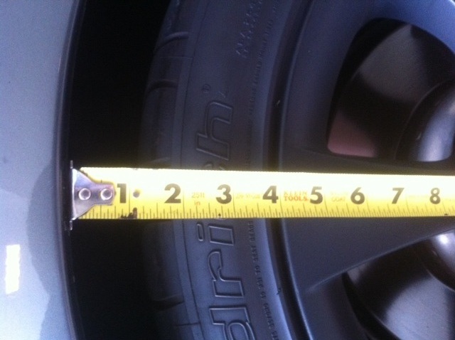

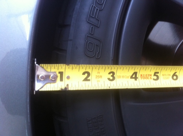

i do not know how long it has been like this, just now noticed. But as you can see below the rear right rim is measured right at 4" but on the other side its almost a inch lower!!
how often does the sport suspension go out. I have about 53k on the car.. never hit pot holes or anything like that.
Is it just time to be replaced? whats the deallio??

Did you measure on level ground?

unfortunately

Have your indy (or dealer if you are CPO) check your shock mounts. I have 60k on mine and blow out a rear shock mount that caused other issues. I never measured but the shock assembly was actually hitting the rear deck when compressing, so it can definitely cause your ride to sit lower. It's about $100 in parts and 2-3 hours labor.

thanks for your knowledge! ill get that checked out!

53k and never had a shock change? The shock is most likely shot or getting there and sagging.

I had the dealer check mine out because I had the same complaint , these cars just sit like that...
