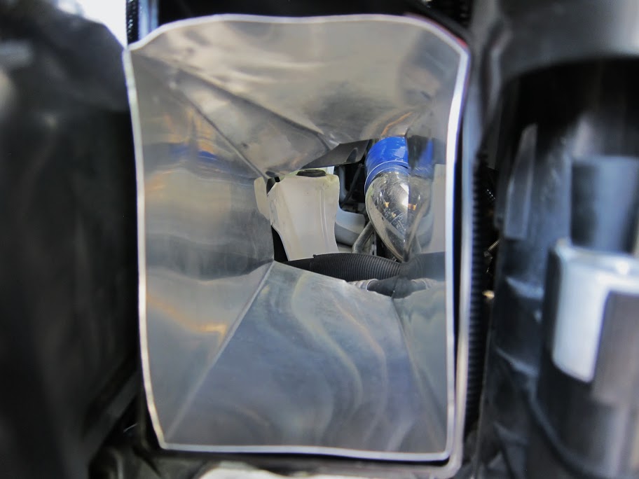

I have taken some steps to minimize the amount of heat around the filter. First I rearranged the heat shielding to act as a partition between the inlet and the manifolds. Then I built some aluminum scoops to help direct cold (outside) air to that side of the engine bay.
