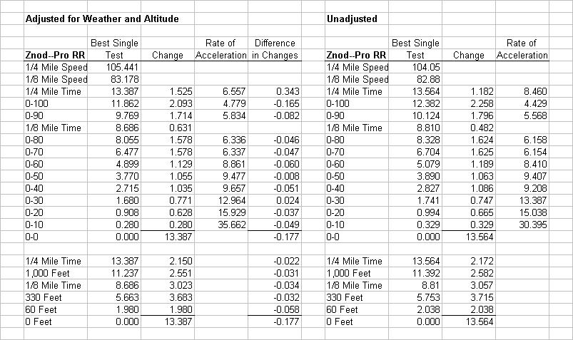

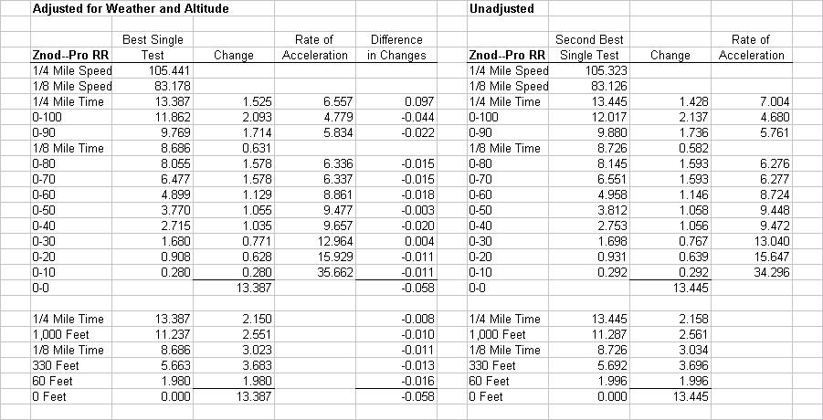

Earlier, I attached a table to post #191 and later discovered a problem with it--my car was faster to all distances, but grogan545's car was faster to all speeds except the 1/4 terminal velocity. Given these, observations, the table didn't make sense. We decided that the problem is that the NHRA correction factors apply only to 1/4 mile data.
Subsequently, I started using a regression approach to estimate interesting weather and altitude adjusted values other than 1/4 mile values. My regression equations appear to be very well fitting. Thus, I think the regression approach is a reasonable one for producing weather and altitude adjusted values for data other than 1/4 mile data.
I have attached a table that compares my best weather/altitude adjusted test results with my best unadjusted test results to start thinking about whether the regression approach produces reasonable looking results. The attachment says "so far so good." Next, I am going to compare the adjusted data from the two tests yielding my two best sets of adjusted 1/4 mile results.

Here is the table referred to above. As mentioned, it compare the adjusted data from the two tests yielding my two best sets of adjusted 1/4 mile results. Again, the results look good, but what ultimately is needed is a comparison of adjusted data from my car having used my regressions and adjusted data from another car having used regressions specific to it.
The right-side of the table is headed "Unadjusted," but both sets of raw data have been adjusted for weather and altitude. I forgot to change the heading for the right side.

Hi Friends:
I did two passes today, while the raw data were very good (but not great), my adjusted for weather and altitude data were quite good--in fact, now my two best (i.e., since I discovered a calculational error in what was my second best pass).
1/4 Speed.....105.778....105.144
1/8 Speed.......83.340......83.054
1/4 ET.............13.382.....13.444
0-100..............11.844.....12.011
0-90.................9.759.......9.878
1/8 ET..............8.684.......8.727
0-80.................8.048.......8.143
0-70.................6.475.......6.554
0-60.................4.898.......4.961
0-50.................3.772.......3.815
0-40.................2.719.......2.758
0-30.................1.678.......1.697
0-20.................0.901.......0.926
0-10.................0.277.......0.290
1/4 ET............13.382.....13.444
1,000'.............11.234....11.287
1/8 ET..............8.684......8.727
330'.................5.661......5.692
60'...................1.977......1.994
What is interesting to me is that the weather is warming up, but nevertheless I am getting relatively better adjusted times and speeds. This observation really shouldn't surprise me because comparability is the purpose of making the adjustments. But, is my car still learning? Will it continue to learn forever? I hope so.
What I am saying can be seen generally by looking at my density altitude values and the related temperatures.
Date: .....................2/18......2/19....2/21...2/22......2/24....2/25....2/26......5/2
Density Altitude:...1223.2...1,239....881...913.3...1,469. 1...726..1,451...1,885.7
Temperature............49.........50......44.1.... .45........52.5......53.5....54.5....57.9
And, note, of course, that density altitute depends on things besides temperature--atmoshperic pressure, dew point, and actual altitude.
