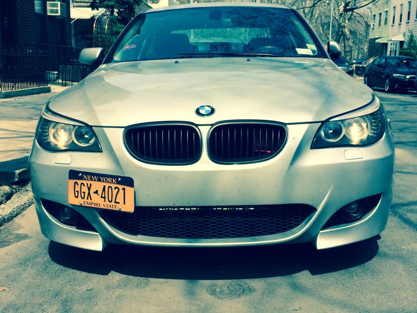

New bulb no angel eyes helpppppp-image.jpgHey guys, recently got a low beam malfunction so went out got some bulbs and changed it.
Problem is, when I turn on parking lights nothing lights up on the side I changed it,
When I turn on the low beams the lights turns on fine along with the angel eye but the one around the high beam does not light up.
I used random sylvania silver stars from autozone h7 55wat
What am I doing wrong?
I took pictures but it's daytime and I only have an iPhone so you can't see anyway
Please help!
Mike

so you changed the low beam and that works. i think you need to also change your angel eye bulb??

So let me get this straight. Your angle eye lights up (on the side you replaced the low beam) but only one eye gets light? If this is the case you either need to reposition the angle bulb because it is probably not in right or you have a tunnel (tube) that has cracked real bad that the light cant travel the distance to the high beam side. If that is not the case and you are nto getting any light at all in the angle eyes then a bulb replacement is all you need of check to make sure you didnt unplug it.
